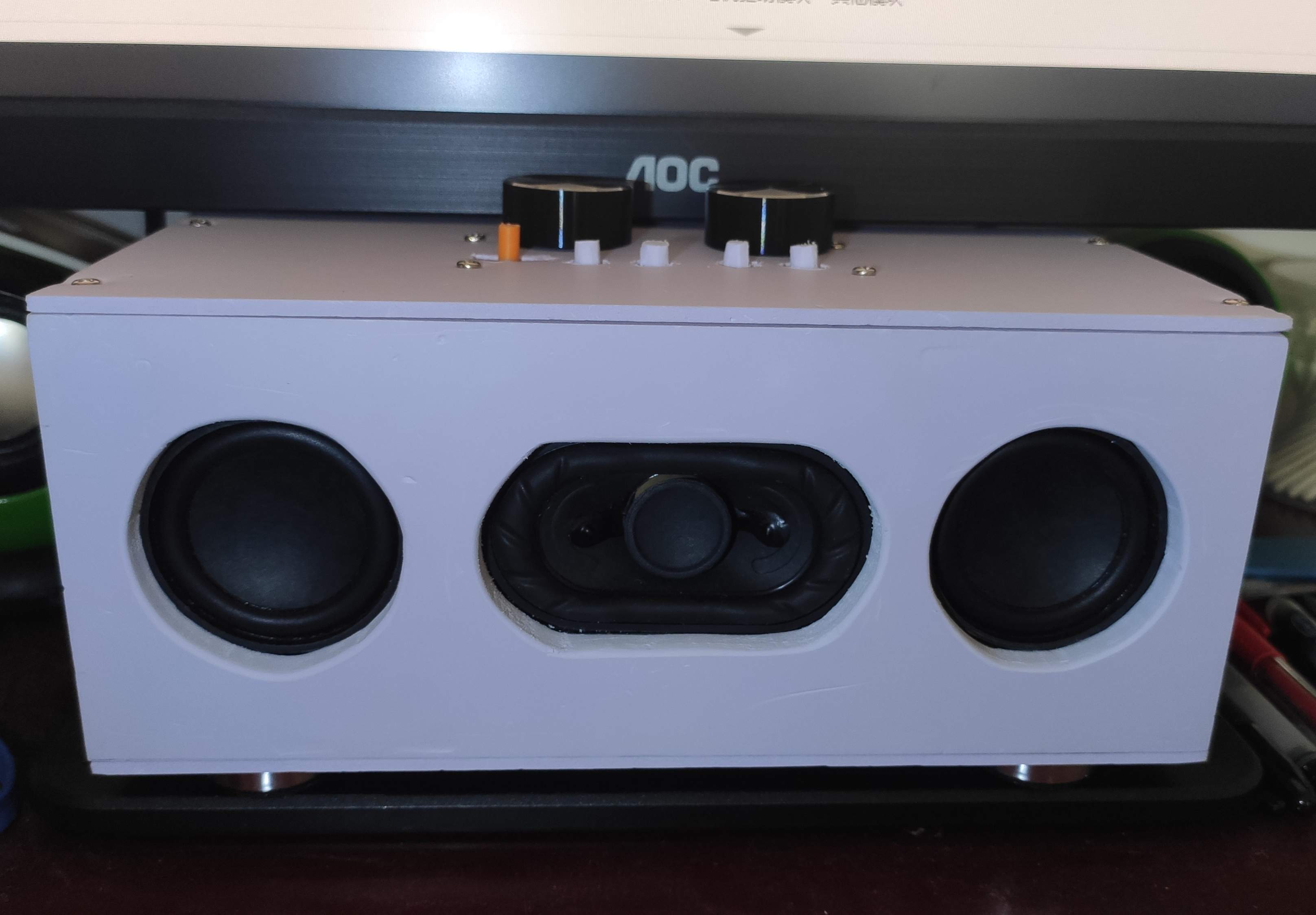

(4) Shell design
        At the beginning, I planned to use black walnut wood to process the shell. However, when I designed the shell model and prepared to contact the seller for processing, one of them said that the model was too complex and could not be processed. The other two sent the model file for inquiry and then heard nothing from them. Later, the delivery time was not enough and I planned to switch to 3D printing. However, the total processing fee for 12 parts was about 500 yuan, so I was directly persuaded to quit. I had no choice but to use Chevron boards to manually process the shell...
Designed speaker enclosure:
Actual handmade…
Rear and bottom:
        Compared with milling and 3D printing, the span is much greater. The circle is not round or square, but after all, we just listen to the sound and make do with it first.
        In terms of sound quality, I am not a professional and cannot comment. Anyway, the bass is so powerful that the whole table is vibrating, but the bass volume cannot be turned up too high, otherwise the speakers will explode. There is basically no noise when connected to AUX, but there is a very obvious noise floor when connected to Bluetooth. I have tried several solutions but to no avail.
