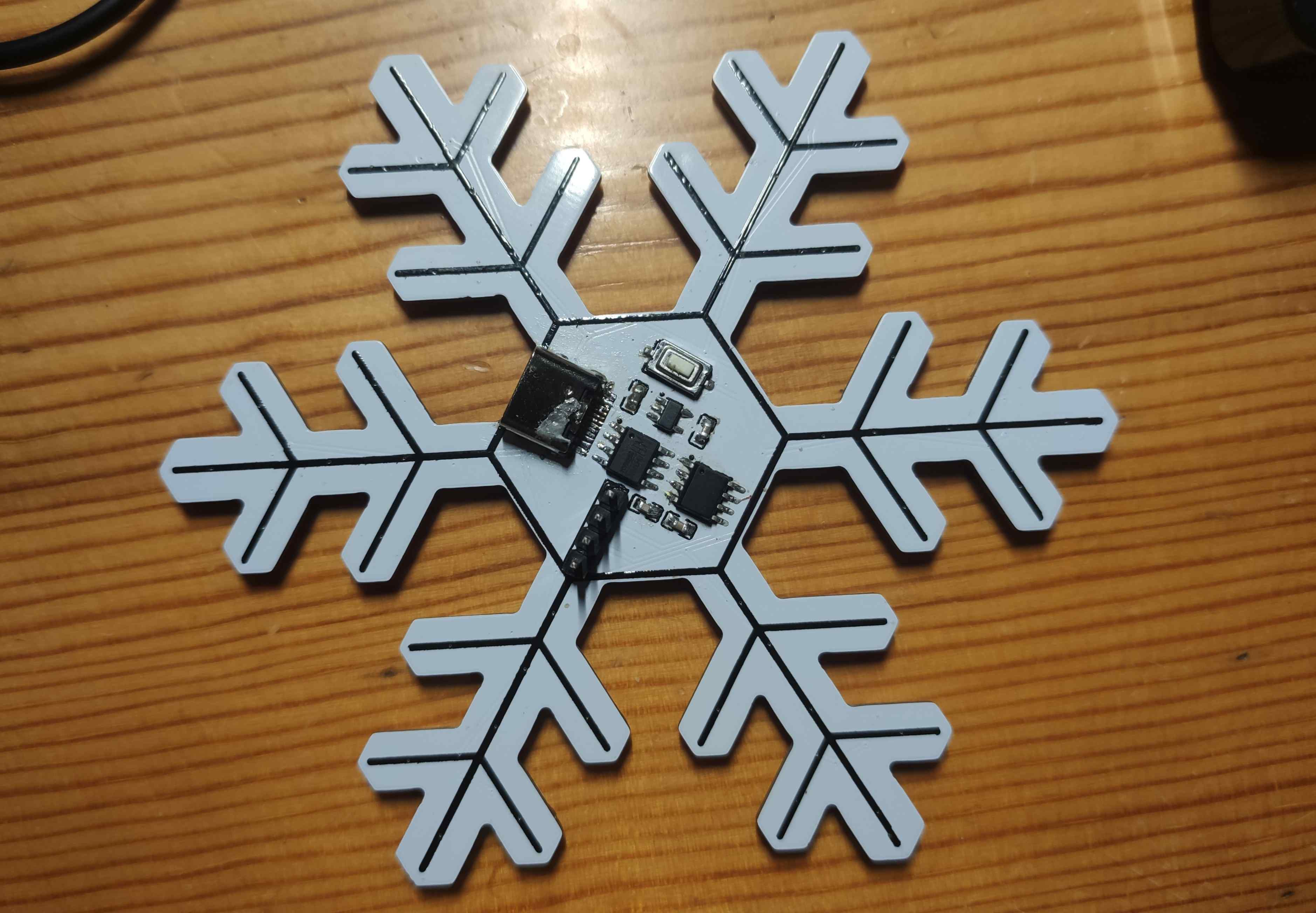

Snowflake lamp using HK32F030MJ4M6 as the main control
Precautions
The TYPE-C female port of this product will interfere with snowflakes. When welding, it can be tilted upward to avoid the situation where thicker TYPE-C data cables cannot be connected.
I think the currently used TYPE-C female socket is more cost-effective, and the upturned welding is also an acceptable solution. I haven't found a female socket that better meets the requirements in the Lichuang Mall. Of course, if you have any better suggestions, please feel free to put them in the comment area

Manufacturing steps
  1. Use snowflake-lights/hardware/Gerber.zip for pattern making
  2. Purchase the device and solder it, please pay attention when soldering
    • Complete the welding of all WS2812 lamp beads first , and then weld the decoupling capacitor to prevent the decoupling capacitor from hindering the lamp bead welding.
    • Upturned TYPE-C female seat .
  3. Test and power on
