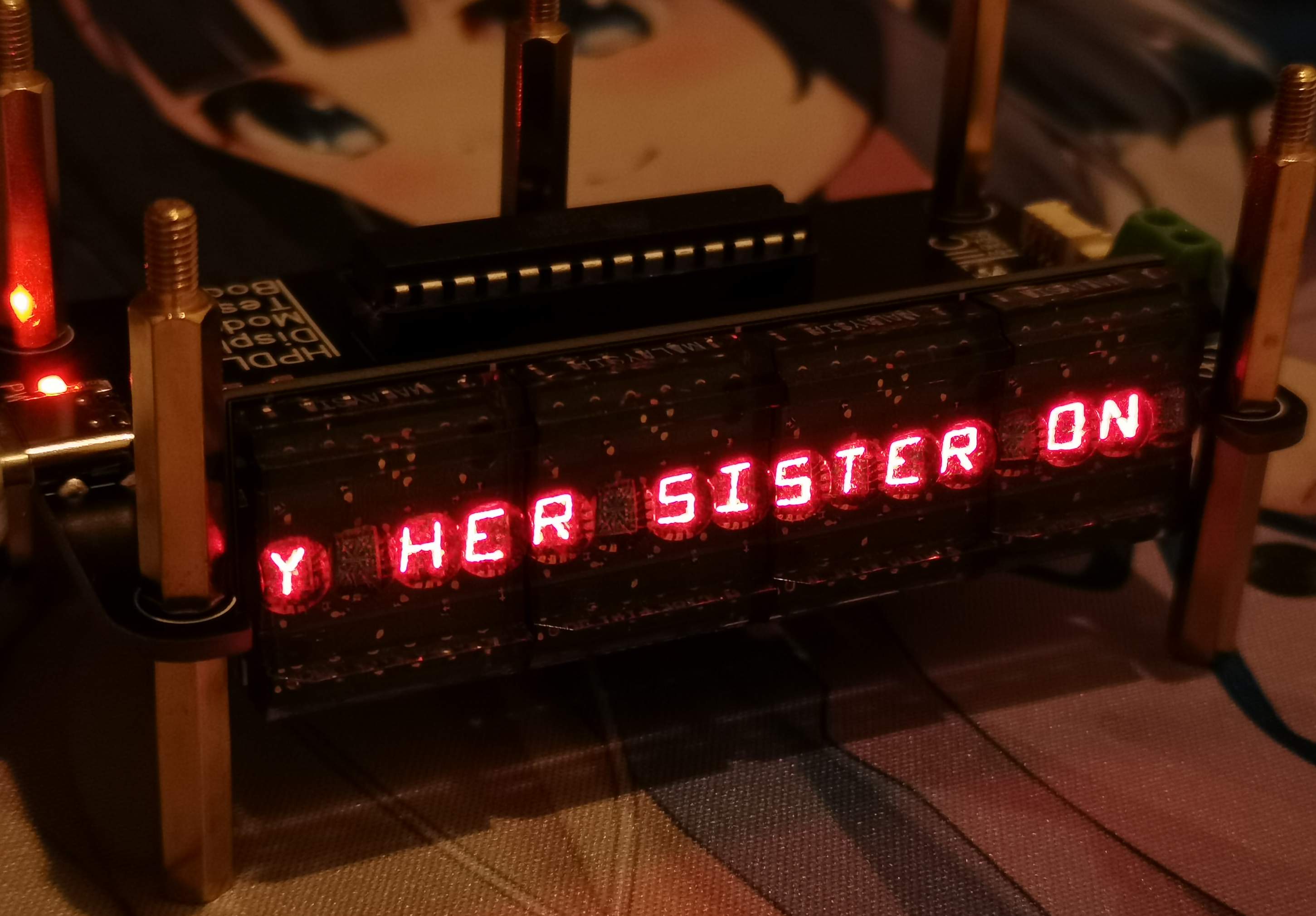

About HPDL-1414
The LED four-digit ASCII character display component introduced by HP in the last century. Due to its simplicity and ease of use and excellent display effect, it has now become a good choice for electronic DIY and nostalgia.
About the display module
4-link HPDL-1414 display module. The module itself only has pins out to minimize size and complexity, so that it can be easily welded or plugged into your final product or solution verification version.

About supporting verification board
The supporting verification board uses ATMEGA-328P-PU microcontroller, comes with USB download (you need to burn the Bootloader by yourself), and leads to the I2C interface and 5 GPIOs with ADC, making it rich in scalability. When the verification board is used as an I2C host, it can be connected to various external sensors or RTCs. At this time, the verification board can become a simple and non-redundant clock, thermometer and other desktop ornaments; when the verification board is used as an I2C slave, it can appear as a Common and easy-to-use I2C display to integrate into your other projects (the above functions require self-programming).
New version description: Reproduce the reset circuit and lead out 5 unused GPIOs with ADC (including IIC interface pins).
Circuit board copper foil layer: 2; recommended board thickness: 2.0mm
Please note: The demonstration in the picture uses an outdated version of the PCB. Please refer to the latest design.

renderings
Display module and old version verification board
Display module and version 1.4 verification version
Display module back
