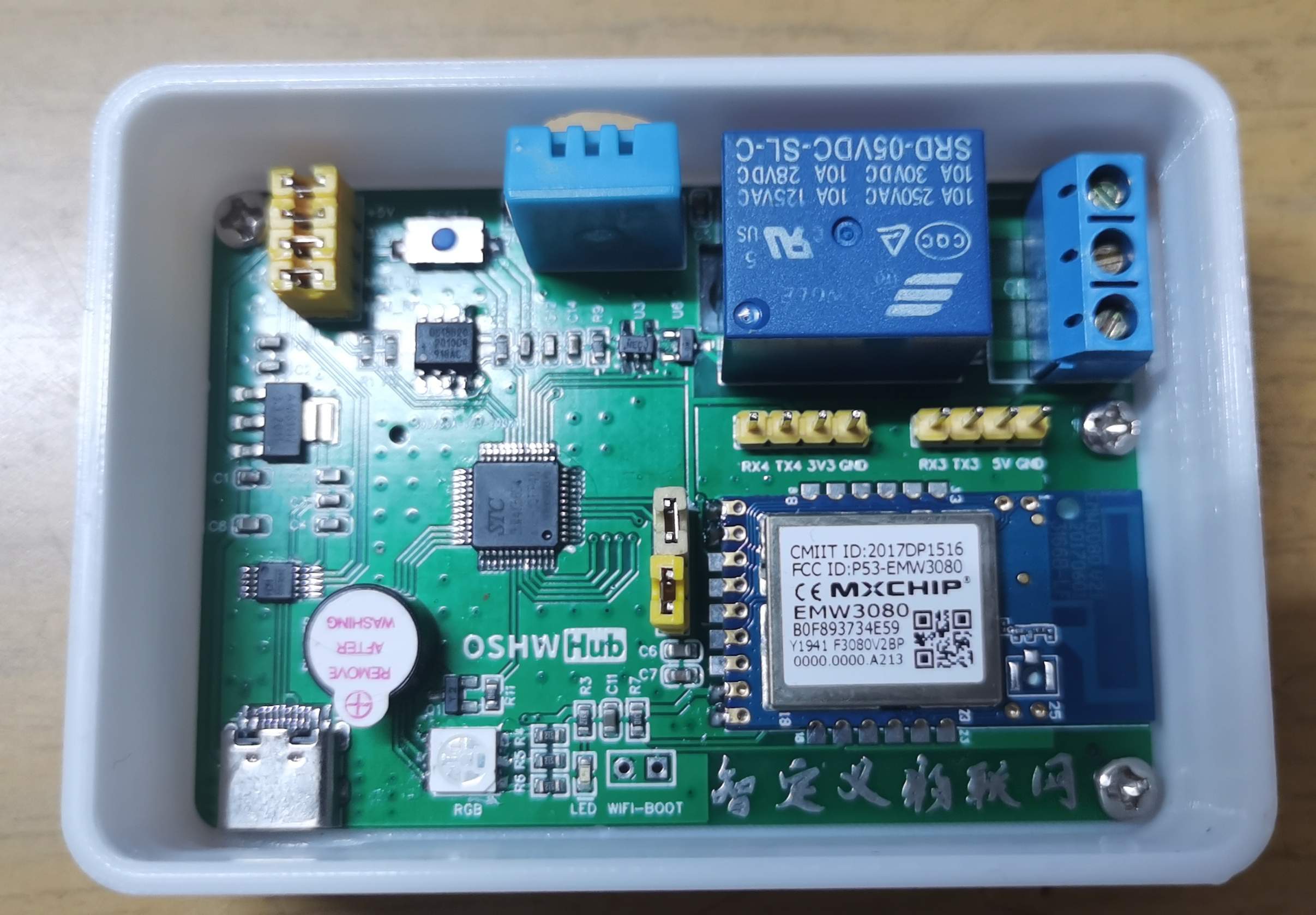

1. Schematic design
1. USB to TTL
Adopt a classic design and follow the specifications. It adopts a stylish, trendy, blind-pluggable TypeC interface and strong current supply capability, which can effectively prevent the CH340 chip from being reset the moment the relay is turned on. 1.png
2. LDO step-down
The AMS117, which engineers are no longer familiar with, is used to ensure stable power supply for communication modules and microcontrollers. No more worrying about power supply. 2.png
3. DS18B20, DHT11 and other peripherals
Onboard is a DS18B20Z+T&R temperature sensor, a DHT11 temperature and humidity sensor, a popular RGB light and buzzer. At the same time, 2 serial ports are led out, namely serial port 3 and serial port 4. If you need 5V power supply, please use serial port 3. If you need 3.3V power supply, please use serial port 4. Onboard RGB and onboard buzzer can be used to prompt users for running status. (The DS18B20Z+T&R patch package used in this design is based on the perspective of "strict diligence and thrift and opposing extravagance and waste", which consumes inventory and also appears more advanced ) 3.png
4. The relay drive circuit SN74LV1T04DBVR inverter can ensure that the relay is reliably turned off when the MCU is powered on, and the NUD3124 can ensure that the relay is reliably driven. 4.png
5. EMW3080WIFI module adopts the classic WiFi chip of home appliances, mass-produced and shipped, mature and stable. Classic design, supports stamp hole SMT or pin installation, suitable for various smart home appliance application scenarios. Use Alibaba Feiyan version firmware to quickly access Alibaba Cloud firmware download address: https://mxchip.yuque.com/books/share/8ac5e519-671d-4444-a93d-20e0aadfc793/pornca 5.png
6. STC microcontroller
It adopts the classic 51-core microcontroller that is the first choice for entry-level engineers. The drive circuit is simple, the peripheral interfaces are relatively rich, and there is a lot of information, which can fully meet the project needs, and the development is simple and easy to use. 6.png

3. Problems encountered
1. The DS18B20 temperature sensor in the chip package is used, but after the board running temperature rises, the detected temperature is higher than the room temperature, which becomes the motherboard temperature detection instead of the originally designed ambient temperature detection (this package is used because I only have This package, destocking design; this question tells us that choosing the right package is important)
2. Use without checking the package library (especially components with polarity). After getting the board, weld all the packages directly according to the silk screen marks, causing the RGB lights to be pasted upside down.
3. When designing the shell, you did not pay attention to the pin length of the direct plug-in component, and did not leave enough space for it after opening the hole, causing the printed model shell to be invalid.
