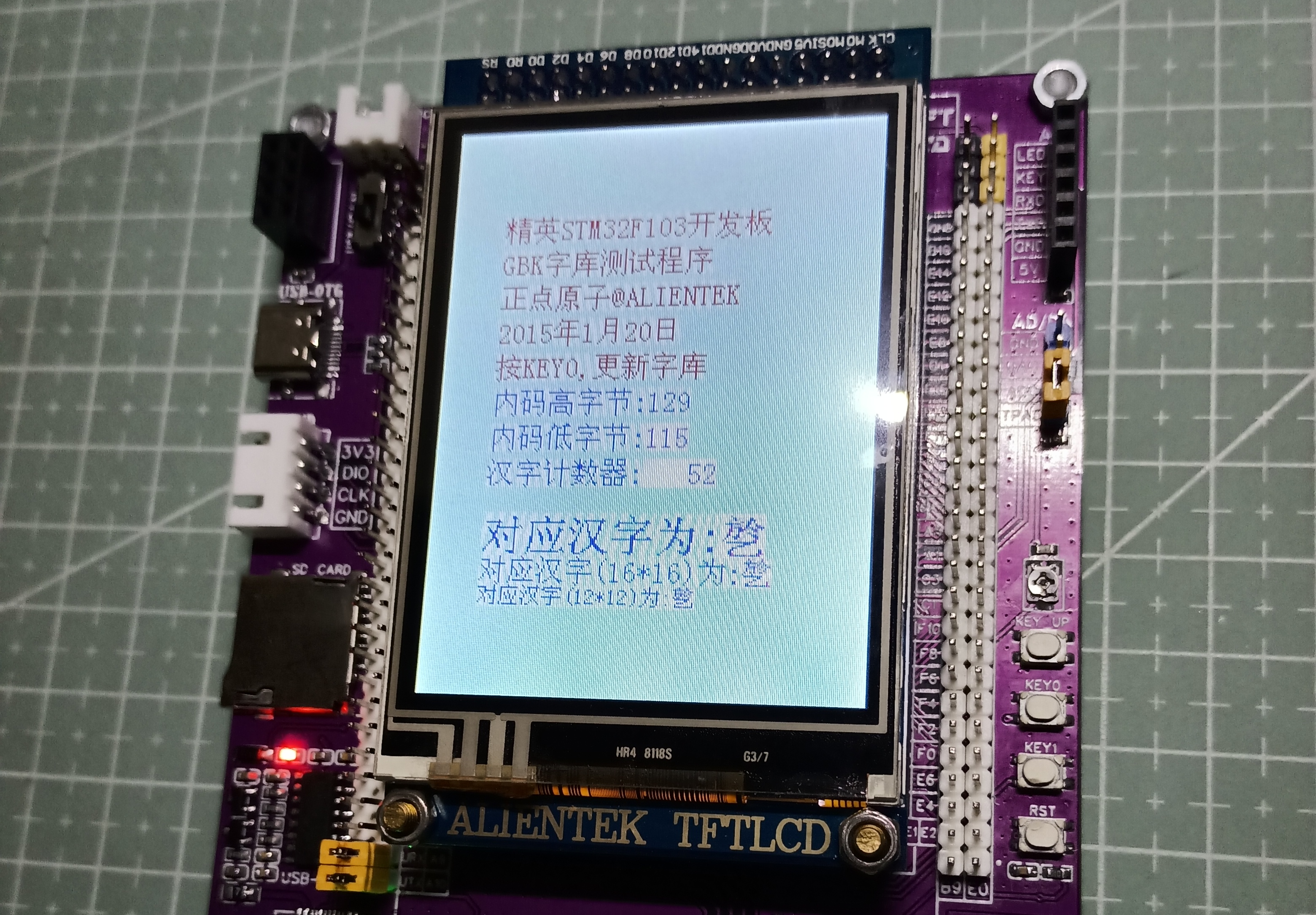

As an electronics enthusiast, wouldn’t it be nice to make one yourself? ! ! ! ! ! ! (Mainly because I have no money)
Refer to the schematic diagram of the punctual atom for design and production
"Easy" to draw schematic diagram;
Convert it into a PCB, then "simplely" lay out a line, and a tall and elegant elite board of the same style as Atom is ready!
In order to reduce the size (I controlled the PCB size to 90*100mm), I removed several peripherals of the elite board and replaced some.
* Remove part
They are RS485 module, infrared receiving module and temperature and humidity sensor DH11 interface
* Replacement part
The USB interface has been replaced with a Typec interface, making the data cable easier to match;
The JTAG interface is replaced by the SWD interface. The SWD download is a little slower, but it is completely sufficient, and the onboard ch340 can also be downloaded, but the download is slower;
Replace the pin header used for switching between boot0 and boot1 with a wave switch to facilitate switching;
The SD card slot is packaged in a smaller size, occupying less PCB area, and small SD cards are easier to find and purchase (cheaper);
The crystal oscillator is replaced with a smaller SMD package;
The buzzer is transposed into the 5030 package (it may be that the buzzer type is different, and the buzzer does not respond when burning the buzzer experiment program);
Replace the photoresistor with a potentiometer;
Note
Except for the buzzer program that cannot be used directly (I use a passive buzzer, Punctual Atom uses an active buzzer), other peripheral programs can be used directly and run normally.
When using the removed parts, you only need to connect the corresponding modules yourself, and the wiring is relatively simple.
The design plan has been continuously optimized and is currently verifying the third version. The content will be updated in time after the verification is successful. The optimization content is as follows:
1. Add a diode to the SWD interface to avoid reverse connection and burn the circuit. 2. Modify the USB-TTL download circuit, replace the original CH340C with CH340K, and make the package smaller. 3. Optimize the wiring, thicken the power line, and modify and optimize the signal line. 4 , modify existing bugs
The following is the first version of the physical picture: IMG_20211013_234744.jpg
The actual silk screen printing is clear and tidy, and the overall layout is relatively reasonable.
Due to my limited level, the wiring is quite stretched. I welcome everyone to further optimize and improve.
If you have better suggestions or ideas, please share them in the comment area.
