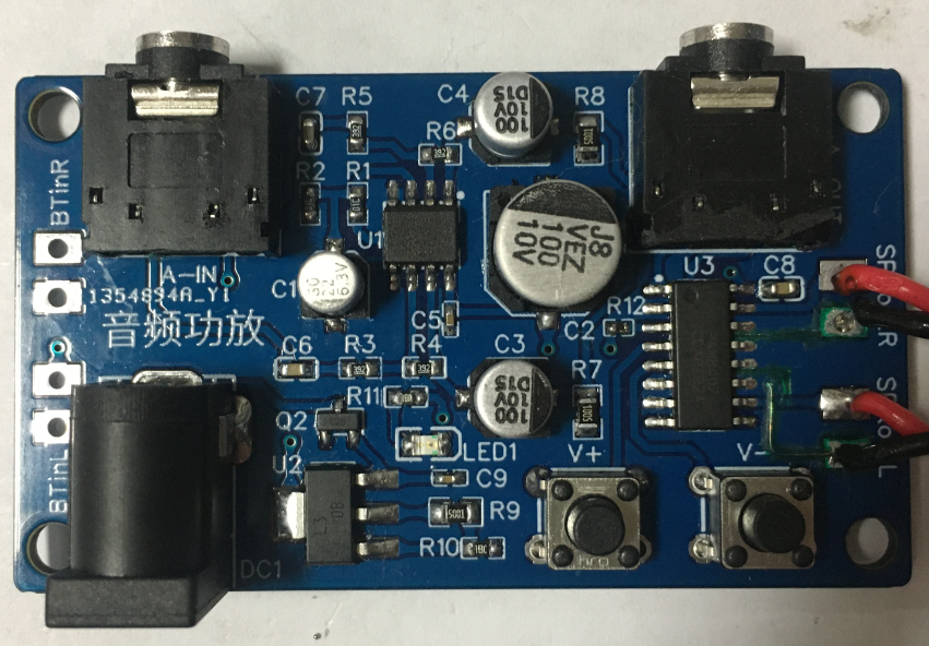

I chose the LM317, which I picked from the mall. I want to use a 12V adapter and use LM317 to transform it to 5V to power the chip.
Because the power polarity of some adapters is that some pins are positive and some are negative, in order to prevent reverse connection, I used an NMOS tube here, and the effect is pretty good.
The output voltage of this circuit is about 5.6V, which is higher than I expected. It is within the working voltage range of the chip, so that's it. I built the circuit according to the LM317 data sheet, why is it higher than 0.6V? Is there something wrong with my choice of R9 (5K) and R10 (15K)? Does anyone know? Please give me some advice. Thank you.

4.2. 3 Speaker amplifier
PAM8407 has relatively few pins and simple wiring, making it more suitable for beginners like me who are drawing PCBs for the first time.
This picture was modified by me. The prototype PCB is different from this one. Pins 14 and 11 were directly grounded by me. As a result, there was no sound from the speaker.
The line was drawn wrong, so I had no choice but to fly the line. After flying the line, the sound came out.
PS: I also drew the wires of my audio input socket backwards, and the left and right channels were connected backwards. Because I drew it from memory, I didn’t think it would be wrong, so I didn’t check it.
If you have obsessive-compulsive disorder, you must fly to solve it. I forgot to take a photo of the finished product. This photo is a semi-finished product.
Also, originally I wanted to connect an audio socket to output to headphones, but it failed at first. Because as long as the headphones are plugged in, the output current of the power supply increases sharply, approaching a short circuit. How could this happen? Plugging in the headphones only disconnects the signal from the TDA1308. I don't understand why the current increases sharply.
Later, I found that when the speaker was first connected to the power supply, the diaphragm bulged. At this time, the ammeter pointer jumped abnormally and the current was high. I guess it's a problem with the speaker wiring. My circuit is based on the circuit taught by Mo Gong during the live broadcast. Logically speaking, it should not be wrong, but the current is indeed abnormal. Since it was a problem with the speaker and the diaphragm was bulging, it was probably because of DC power. There was no capacitor connected to the speaker in Mo Gong’s circuit, so I soldered a 100uF capacitor on the speaker’s binding post (see the picture below), and a miracle happened. The current is not large anymore, and the current does not increase sharply when the headphones are plugged in. At this point, all the functions I wanted to implement have been achieved, and I am excited.
(PS: The second and seventh pins of PAM8407 have been connected in series with a 0.1uF capacitor, and the circuit diagram has been corrected)

4.3 Final product display:
The flying line is a bit ugly and the drawing has been changed .
