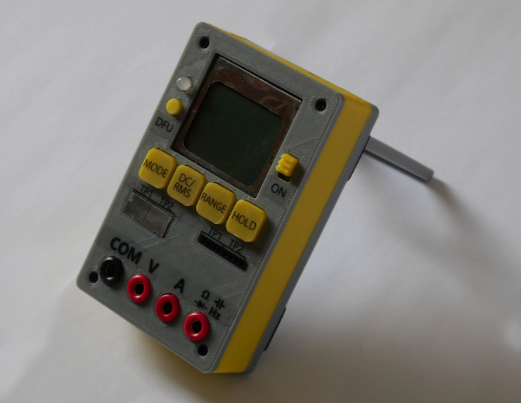

1. Voltage measurement: ±60 V, ±6 V, ±600 mV, ±60 m range, with DC or RMS data acquisition
2. Current measurement: ±250 or ±2500 mA range, also using DC or RMS
3. Can measure voltage and current at the same time and display the product, that is, power
4. Continuity measurement and display of resistance and voltage drop
5. Simple component testing can be performed
6. Frequency measurement up to 10 MHz
Additional features: Isolated USB serial port ; 2KB EEPROM; 4-bit expansion port; battery voltage measurement and USB charging; firmware update via USB; integrated stand; retention function
Note: This project was started using STM32F1, now it uses STM32F3.
