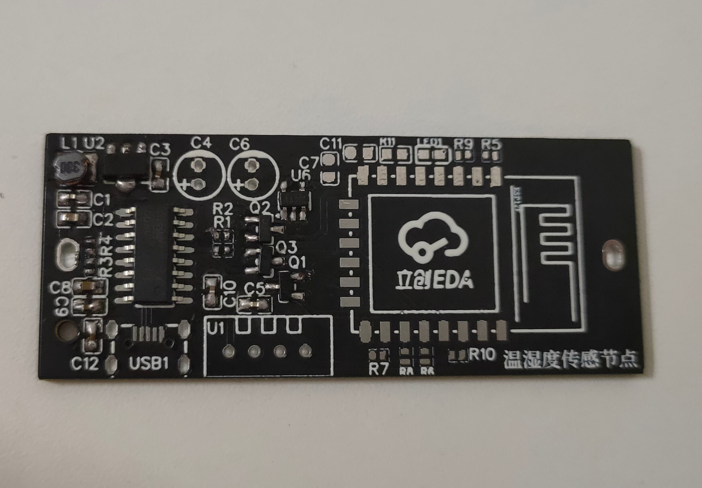

WIFI wireless temperature and humidity sensing node
Temperature and humidity sensing node based on ESP8266
  • Low power consumption, one-cell design dry battery power supply
  • DCDC rushes to the 3.6V ( QX2304L36E ) voltage range
  • DHT11 sensor, MOS controlled power supply to prevent unnecessary power consumption
  • Using CH340C to UART and supporting the corresponding circuit, the firmware can be directly burned, eliminating the need for a crystal oscillator and reducing the occupied space.
  • USB power supply uses LDO to step down to 3.3V
  • Tentatively, I plan to use the NODEMCU platform to write LUA. If low power consumption is not enough, I will consider using the ARDUINO platform. If it still doesn't work, I will use the ESP IDE. (Yes, the program is not implemented yet.
