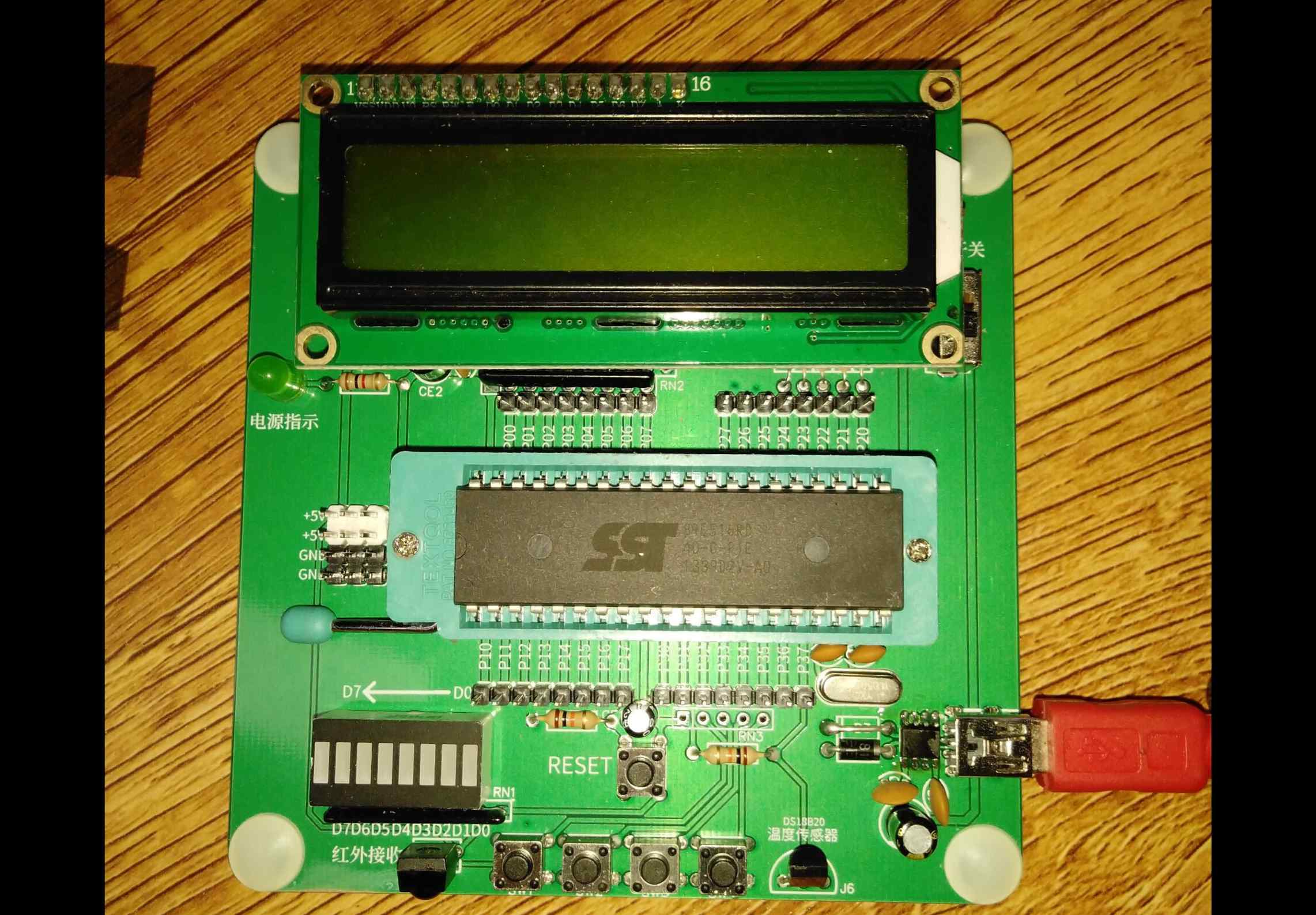

Be careful not to block the pad hole when welding. The first step is to solder the CH330N chip. You can put high-temperature tape on the hole next to it to prevent it from being accidentally blocked.
Then plug in each component and solder only one pin to fix it. Be careful not to insert the diodes, light strips, and resistors in the wrong direction.
After fixing one pin, use a multimeter to measure and confirm that it is not inserted backwards. After everything is fixed, turn it over and solder all the unsoldered pins.
STC 89/90 series DIP-40 packaged microcontrollers can be used. You can also use the SST89E516 or SST89E58 chip for simulation debugging.
SST89E series chips need to use Weiner SP200S programmer to flash BSL firmware. You can also use Puzhong 51 microcontroller emulator for simulation debugging

Physical welding photos
Simulation joint debugging effect:
Click to view the larger image. MSC51.gif Attached is a simple test code and demonstration video.
