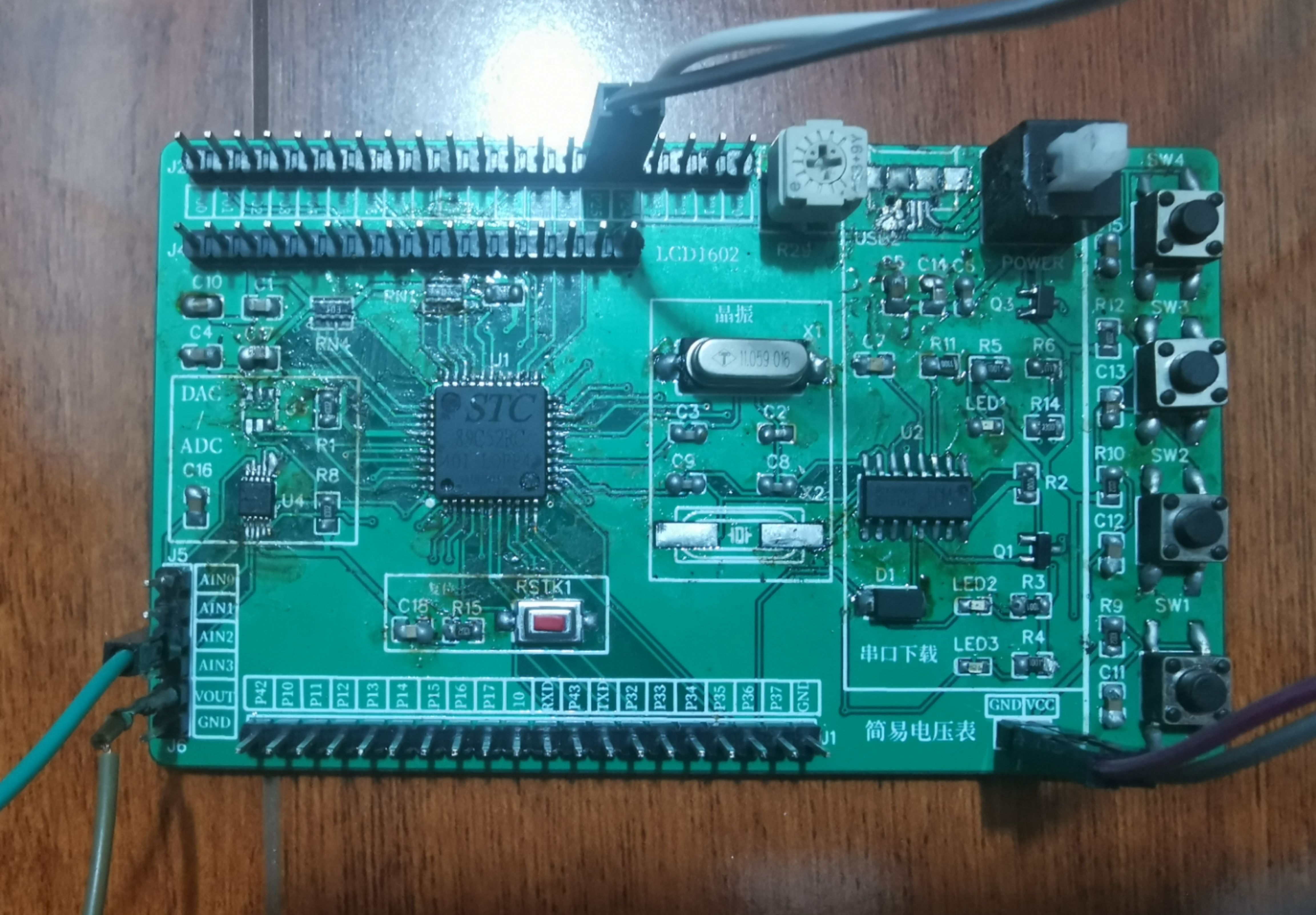

5. Circuit diagram and PCB
Schematic diagram
Regarding the design of a simple voltmeter, our group chose the STC89C52RC-40I chip. This chip has 44 pins and its package is PCLL.
  • First, you need to design a minimum system board. The basic parts are as follows:
(1) Clock circuit: An 11.0592MHz passive crystal oscillator is used to provide the clock signal, and load capacitors are connected to both ends of the passive crystal oscillator to ground.
(2) Reset circuit: When powering on, the capacitor is charged and the RST pin is high to achieve reset. When the RSTK1 button is pressed, the current flows into the ground through R15, and the high level at RST is reset.
(3) Serial port download circuit: Use CH340G chip to realize USART serial communication. When the six-pin self-locking button POWER is pressed to power on the microcontroller, it can be judged whether the power is on normally by the red LED light of LED1 turning on and off. When burning a program or communicating, you can judge whether the communication is normal or not by turning on and off LED2 and LED3.
(4) Independent buttons: Each time the power is turned on, the capacitors are charged. KEY1, KEY2, KEY3, and KEY4 are at low level and then remain at high level. When the independent button is pressed, they are at low level.
(5) Pull all the pins of P0 high to use as IO output ports; in addition, connect EA to high level to access the internal program memory; add two pin headers and connect them to VCC and GND respectively as a backup power input interface; connect some Pins are drawn out for easy control of other modules, etc.
  • After designing the minimum system board, start designing the module to implement a simple voltmeter:
(6) ADC: To measure the voltage, use the ADS1115 chip to collect the voltage, and connect the four input ports of AIN0-3 to the 4-pin header. In addition, the two pins SCL and SDA used for I2C communication are connected to pull-up resistors and pulled high, the ADDR pin is connected to ground to define its address, and ATERT/RDY is connected to P15 and left.
(7) LCD1602: After it can convert the voltage, it still needs to display. Use LCD1602 to complete it. Pin 3 of the interface circuit is connected to a 502 variable resistor to adjust the brightness of the backlight screen and lead out other pins, D0-7 Connect to P00-P07 to achieve parallel communication. The EN, RS, and WR pins are connected to P34 to P36, and the default is high level (P1 to P3 of the 51 microcontroller default to output high level)
(8) DAC: In addition, in order to facilitate the supply of voltage to the ADC part for testing, the DAC module extension part is designed. The chip uses DAC5571, which communicates in I2C mode. A0 is grounded to define the address. The SCL and SDA pins are connected to the same two-line microcontroller IO port as the ADC's I2C communication. The VDD pin is connected to the VCC power supply and filtered through a 100nF capacitor. Lead out VOUT, connect it to the 2-pin header output, and connect a filter capacitor at the same time.
PCB diagram
  • PCB design is divided into the following steps:
(1) PCB rule design: power line (VCC, GND, 5V) line width is 20mil
(2) Frame design: Circuit board width 97mm, height 57mm
(3) Layout: As shown in the picture above
(4) Wiring: using automatic wiring
(5) Add silk screen: Silk screen draw the number of the pin header
6. Debugging and test results
Difficulties encountered during debugging and solutions:
  • Difficulty 1: The USB socket cannot be recognized. Reason: The crystal oscillator of the serial port download circuit was wrongly selected at the beginning. It was 11.0592MHZ. However, the ch340 chip requires that the minimum crystal oscillator cannot exceed 11.98MHZ. Solution: Change the crystal oscillator to 12MHZ.
  • Difficulty 2: The dac module fails when detecting voltage. Reason: The DAC module uses DAC5571, and its broadcast address conflicts with the ADS1115 address on this circuit board. Solution: Change the DAC module to another board and change the address on the other board. The iic pins are led to the mainboard p25 and p24 pins through Dupont lines to avoid iic address conflicts between the two modules.
  • The DAC module uses DAC5571, and its broadcast address conflicts with the ADS1115 address on this circuit board. Solution: Change the DAC module to another board, and lead the iic pin on the other board to the motherboard p25 through the Dupont line. p24 pin to avoid iic address conflict between the two modules (the schematic has been improved and this problem has been solved, but the code has not been updated)
  • There is an error of about 0.05V in the final debugging result. The main reasons for the error are: (1) The voltage provided by the notebook is unstable (after measurement, the voltage provided by the notebook is about 5.07V) (2) The purchased DAC chip is cheaper and its accuracy is not enough. (3) There is a certain error in the Ads1115 chip itself. (4) When writing program code, the measured values ​​are stored in variables defined by floating point numbers. The changed amount is prone to errors in calculation.
