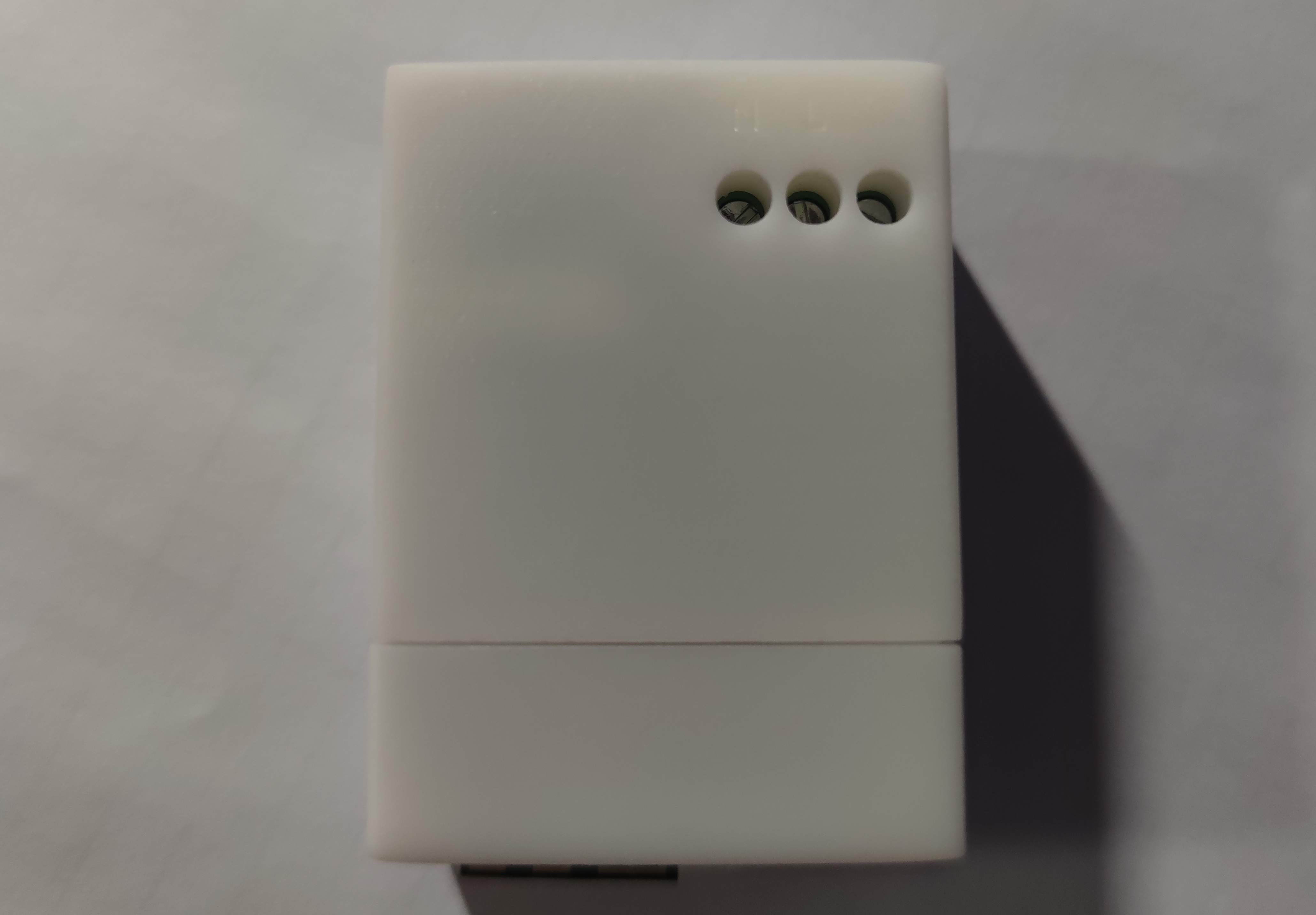

The picture below shows the normal operation of the IoT socket. For a project demonstration, see the attached IoT socket optimized version demonstration. Cover1.jpg
