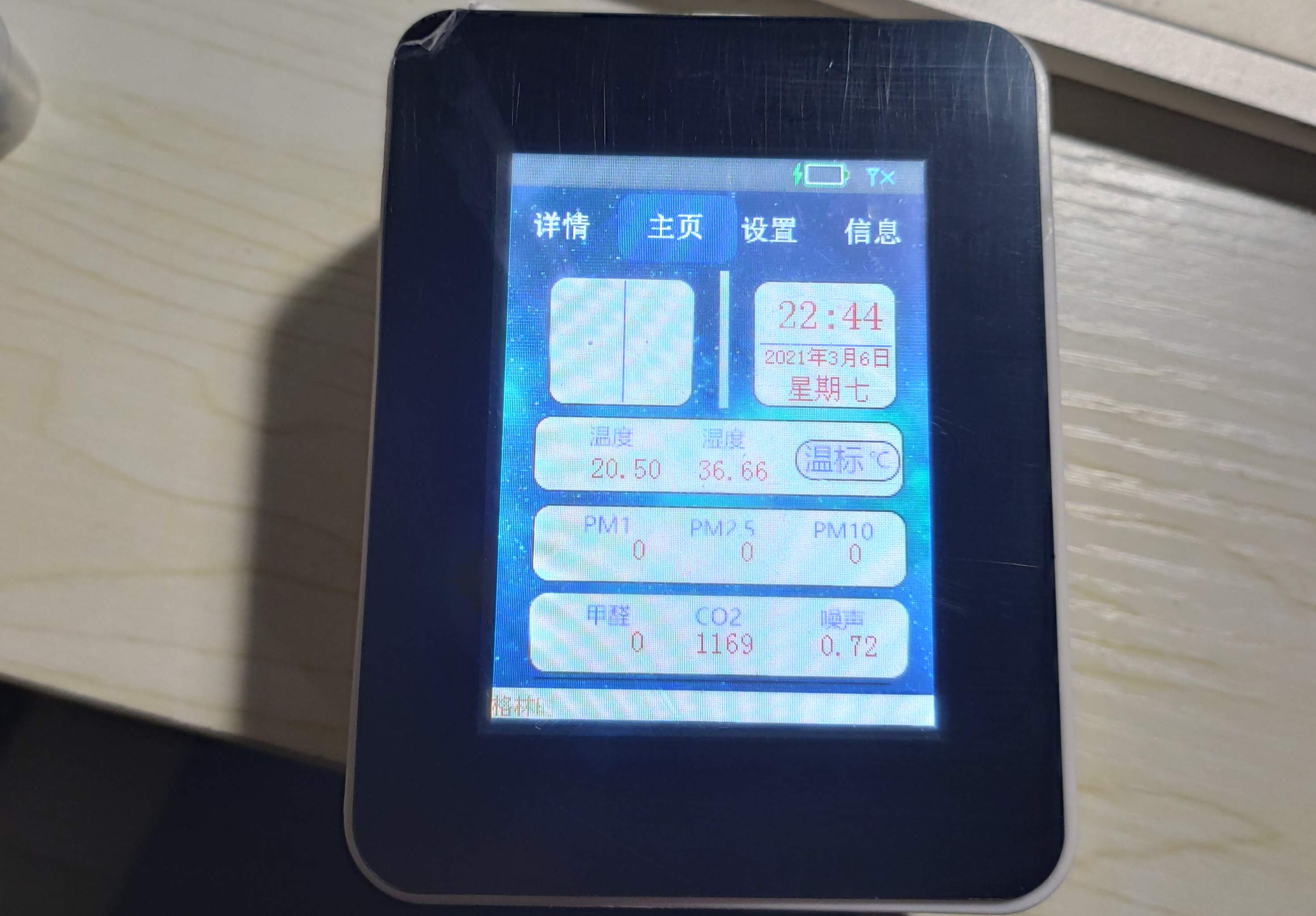

All basic functions have passed the test and are all normal. All functions have been realized. Except for the amplification design of the op amp part that is too high, the rest of the circuit is normal (V2 version has been corrected).
       In the PCB layout, the Tuya module uses a module with an IPEX interface. If the antenna is not plugged in, no radio frequency will come out. You need to plug in the radio frequency antenna (V2 version has been corrected).
The code is shared on GitHub, there is a link at the end of the article, and only the firmware is provided in the attachment.
Finished product renderings:
To facilitate debugging, the panel is not attached.
Actual circuit board:
                              Component side
                                   screen surface

1. The user interface is divided into main interface, details page, settings page and information page.
   1) The main interface mainly displays the actual parameters of several important detection data (PM1, PM2.5, PM10, temperature and humidity, formaldehyde, carbon dioxide). The main page has weather and calendar functions, which can display weather information released by the current city.
   2) Details page, this page can display the data of all sensors, and the data is updated in real time.
   3) Setting page: This page can modify some parameters of the control box (such as temperature scale, calibration time, reset WIFI, etc.).
   4) Information page: This page can display the box’s operating information and author-related information.

5. Description
1. The program is written using a firmware library, and the code is constantly updated to fix bugs.
2. The box uses an LCD screen, which supports Chinese character display and picture display. Since Chinese characters and pictures are to be displayed, a Chinese character library and a picture library (used pictures) are required.
The font library and image library are stored in external Flash (W25Q128). If there is no image library and font library in W25Q128, the box cannot operate normally.
3. The font library and image gallery are written together with the STM32 program when downloading the box program. The principle is to load the STM32 external SPI Flash programming algorithm through MDK to program W25Q128.
It only needs to be programmed once, and there is no need to modify the internal data of W25Q128 later. Modifying any part of the microcontroller program will not affect the font and library data inside W25Q128 (except for full chip erasure).
4. Compared with the capacitive screen, the resistive screen used for the display screen has a slower touch response and is prone to error detection, so do not click too fast during operation.
5. Please refer to the instructions in the attachment for how to download the font library and image gallery.
