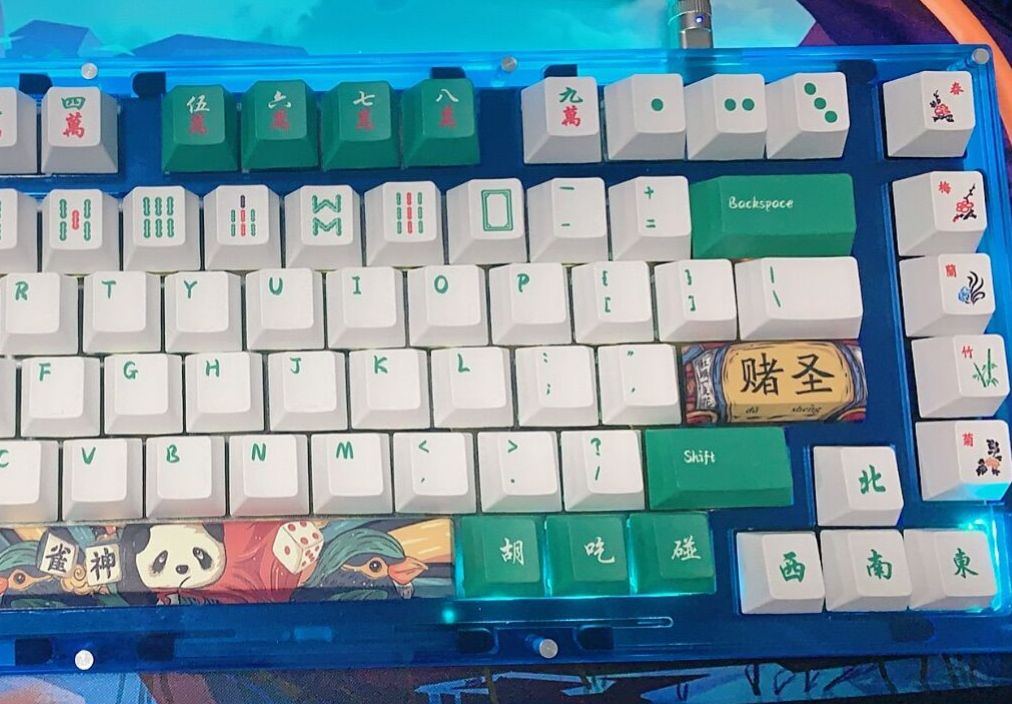

Hanwen (Hello World) mechanical keyboard separation board is
used for acrylic stacking body verification, etc.
It is recommended to make a reverse board (color and thickness don't matter, as long as it can be baipiao)
Components:
FPC seat is exactly the same as the main body (0.5mm 8p)
Two 0805 5.1k
16p Type-C female seat
FPC cable (according to the board and stacking, the middle outlet is recommended to be reversed 150mm)
Touchpad FPC cable chooses reverse 100mm
Cheap acrylic stacking verification: blue transparent (6+5+6+3 on the left) and pink transparent frosted (all 3mm)
Drawings will be open source later Assembly tutorials will be seen later B station
