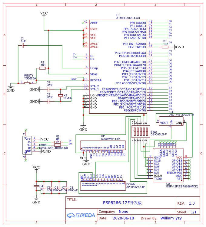

1. Development board parameters 1.Mcu: ATMEGA32U4
2. BootLoader: Arduino Leonardo
2. How to upload the firmware of ESP8266 1. Turn all the DIP switches on the development board to ON
2. Please refer to this article next
3. How to start ESP8266 normally 1. Turn switches 1-4 of the DIP switch on the development board to ON and switch No. 5 to OFF (please turn all DIP switches to OFF when uploading the ARDUINO program)
