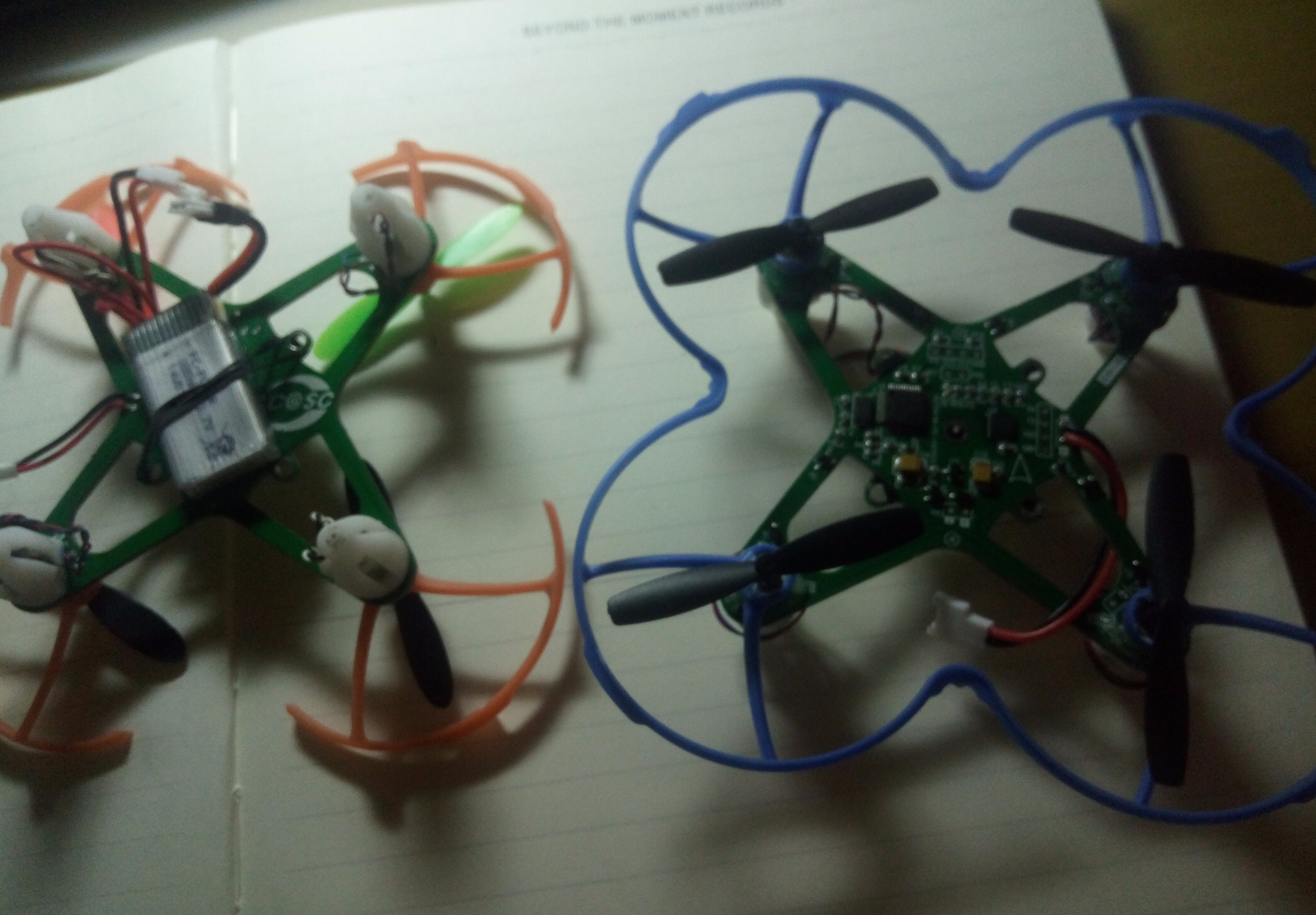

[Please fill in during the registration stage↓] * Brief introduction to the work: Secondary development based on open source small four-axis UAV data on the Internet. The main goal is to omit the remote control board and integrate the NRF2401 communication of the four-axis UAV board. Omit it and switch to Bluetooth 2.0 communication, which connects directly to the mobile phone to achieve short-distance communication and remote control of the drone via the mobile phone APP, thereby reducing the production cost and technical difficulty of personal DIY small four-axis drones.
[Please fill in during the competition stage↓]   1. Details of the work; 1. Picture display of the work: Screenshot of the front of the PCB          image.png         Screenshot of the back of the PCB          image.png         3D proofing 8520 coreless cup motor bracket footing (to prevent the motor from being fixed crookedly and the installation height is different)          image.png     2. The function of the work Description: The Bluetooth version of the small four-axis drone uses the BT2.0 module to communicate with a mobile phone or PC. The operation and parameter settings of the drone have been implemented using Bluetooth serial communication. In this way, it is an independent aircraft. You can connect and control it with your mobile phone.   2. Describe the challenges faced by the work and the problems it solves; There is a lot of open source information on small four-axis on the Internet, from PCB to flight control source code, which can be found everywhere. It is really difficult for a flight control novice like me to have never worked on a four-axis For aircraft, if you don’t even know what the flight control algorithm is and just build a drone, you can only “move bricks”, and you can only move bricks with the lowest technical threshold. Therefore, I collected a lot of flight control information from the Internet and looked at many implementation plans, and finally chose the "DST open source small four-axis" to test the waters. There are three reasons. First, its main control chip is STM32F103C8T6, a very popular microcontroller that I am very familiar with. Second, its cost is low, and I can make it cheaper to DIY by omitting the remote control board. One set is enough for less than 100 yuan. Third, after seeing its PCB structure, I had a new idea. I wanted to add an electromagnet to it to carry small objects, so that small valuable objects such as medicine spoons and game coins can be picked up and put down in flight. , that would be more entertaining. Challenges faced: The first time I came into contact with a drone, I first had to make it fly. I think this was my biggest threshold. Problems solved: The remote control board is omitted, and the mobile phone APP controls the flight of the aircraft through Bluetooth, thereby reducing the production cost of a DIY small quadcopter by half. The entire system saves the remote control part, simplifies the software program, and reduces the technical difficulty. The installation structure solves the problem of inconsistent inclination and height of the coreless motor and PCB installation.
3. Assembled small four-axis UAV image.png4. PID debugging of small four-axis UAV image.png5. Calibration of MPU6050 sensor. I always say that the sensor of my aircraft is not calibrated properly, so I will enlarge the trick and float it in the basin to calibrate it. You can always keep it level.IMG_20190917_230953.jpg
