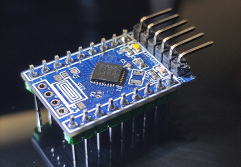

MSP430FR2533 core board
The main control is MSP430FR2533, SRAM 2KB FRAM 16KB. The microcontroller is FRAM, which is a ferroelectric series microcontroller. It is compatible with MSP430FR2633 in the same package. This development version leads to all gpio, P1 and P2 and P3.0 P3.1P 3.2. A total of 19 available , but the dedicated capacitor io is not led out. The resources on the board include the power indicator light. One controllable LED is located on P1.7, and one has an interrupt button. The reset is not used much, so it is placed on the back. If P3 is not soldered below, it can be used directly. Plug into the breadboard, and the debugging port leads to a serial port standard SWB download interface and VCC GND. Since TI's emulator requires writing programs and the corresponding microcontroller is relatively expensive, there is no place here, and downloading BSL is not interesting enough. I am relieved when I think that this is a mini development board. The cheapest solution is the onboard simulation of the G2ET development version. device. The corresponding baseboard is under development (new project. -0/), which will house the ez FET lite emulator and other useful peripherals. Video about using this: https://www.bilibili.com/video/BV1WE411M7yb
