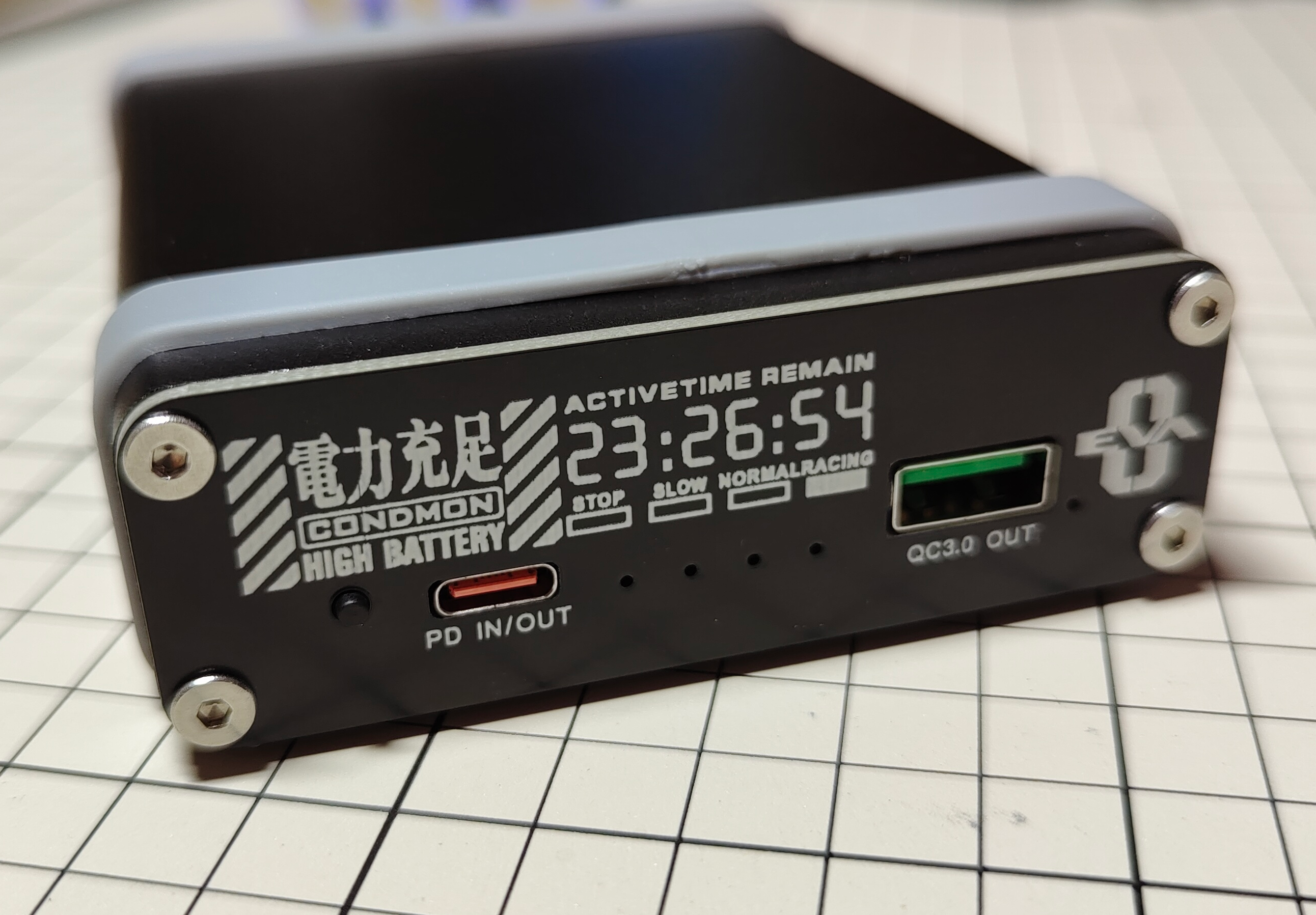

Two-way multi-protocol fast charging power bank/power bank
There is also a 18685 battery version
https://oshwhub.com/wzw666/5358pro
The main control chip adopts Yingjixin’s IP5358-BZ
Integrated QC2.0/QC3.0/SCP/VOOC output fast charging protocol, FCP/AFC/SFCP input and output fast charging protocol, MTK PE+1.1&2.0 output fast charging protocol, USB C/PD2.0/PD3. 0 input and output protocol, USB C PD3.0 PPS output protocol, compatible with BC1.2/Apple/Samsung mobile phones
4-light power display with fast charging indicator light
1 TYPE-A port supports 22.5W maximum power output and integrates all 22.5W fast charging protocols
1 TYPE-C port supports 22.5W maximum power input and output, integrating all 22.5W fast charging protocols

Aluminum alloy shell
