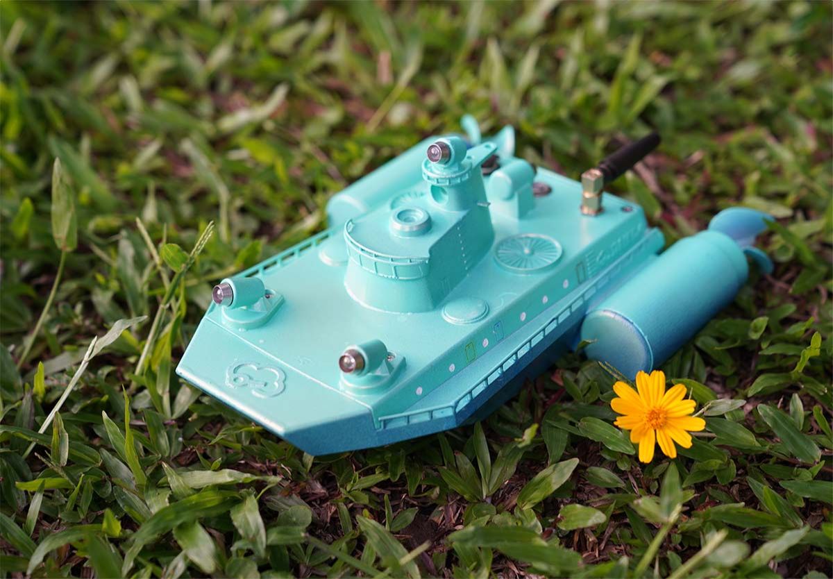

Looking at the timetable, the open source official has not released a project for a year! After much deliberation (under the coercion of Sister Ju), I finally decided to make a work with a sea, land and air theme.
For the "land" of the sea, land and air series, we have already made a [Lichuang Intelligent Car] before . It happens to be summer, so let's make a water project~
It is not a tank QAQ. Although it looks like a tank, it cannot fight on land and can only swim on water.
After three version iterations and model modifications, I confidently took it into the water, however...
It has done all the things of capsizing, drowning, and spinning in circles. If I hadn't fished it out quickly, I would have stayed with the fish in the lake for the rest of its life (it sounds quite romantic).
Although there are still many functions that have not been perfected, they are already movable, and the remaining functions need to be slowly iterated after free time.

  • Two servo interfaces are reserved for later expansion of functions.
  • Comes with matching 3D shell files for easy design of customized shells.

  • After the boat is assembled, it needs to be balanced
  • The remote control needs to be paired before use
  • After the shell is assembled, it needs to be aligned and caulked and waterproofed.
Summarize
Because I have been busy recently, the boat design has been hasty and the functions are a bit off. I will iterate the version later when I have time. Finally, I would like to thank several of our friends who participated in the design and debugging. We look forward to a more complete boat design in the future.
