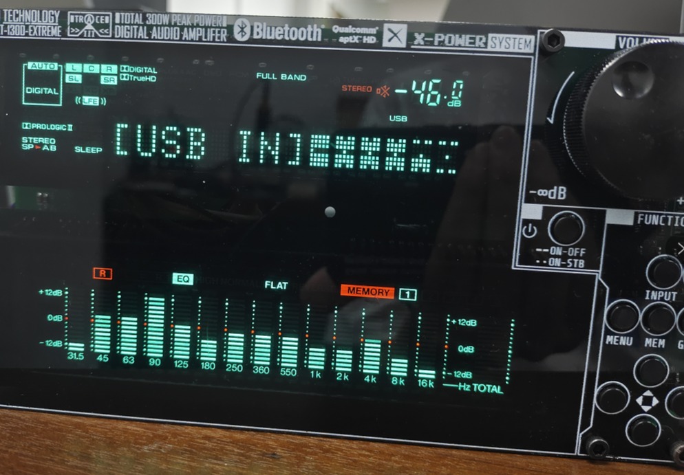

Physical map
Motherboard (not fully soldered)
EQ and filter modules installed
Acrylic panel
Display panel (no acrylic panel installed)
