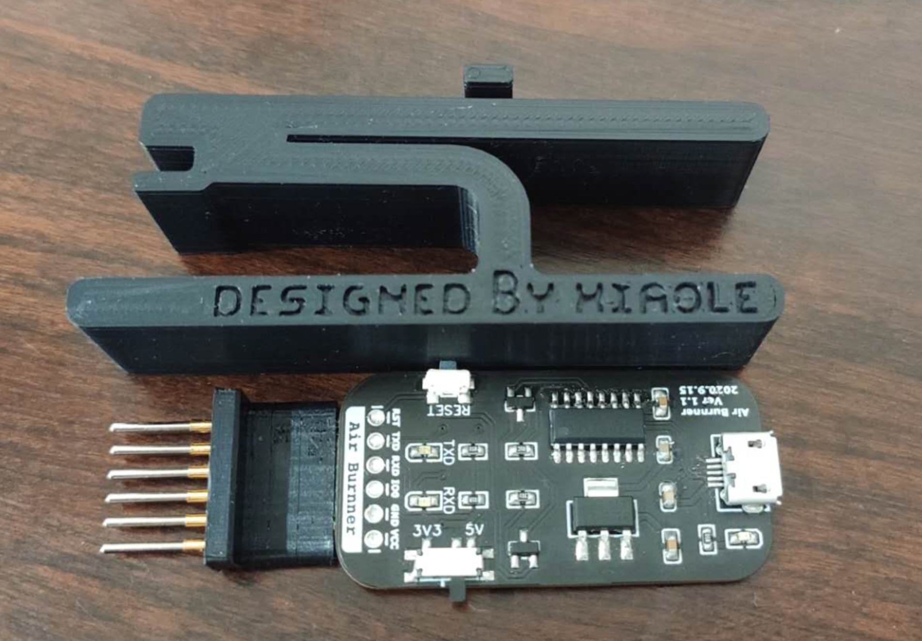

  • The ESP downloader with Air Burnner interface can be used for welding pin headers and DuPont cable connections.
  • Or use the welding probe handheld
  • Or use magnetic probes to free your hands
  • Or use a clip to hold the probe
Assembly instructions
  • If you use a probe, you need to purchase a Ronghua 1.0mm round head probe.
  • The probe head and clip are 3D printed and assembled.
  • After the probe is inserted into the probe head, it can be soldered on the writer
  • Probe head can be mounted on the clip from both sides
  • To assemble the magnetic suction head, you need to purchase 5mmx1mm magnetic sheets and 5mmx4.5mm magnetic sheets.
  • The 1mm magnetic piece is installed on the base, and the 4.5mm magnetic piece is installed on the magnetic head.
  • The base is aligned with the package and adhered to the PCB with soldering glue. Pay attention to the polarity when installing the magnetic piece.
Package Description
  • The schematic diagram and PCB package names in Lichuang EDA are as follows
  • Probe burning interface: Free_Air_Burnner_Pad
  • Pin header burning interface: Free_Air_Burnner_TH
  • Magnetic burning interface: Free_Mag_Burnner_Pad
Magnetic burning model
fixture model
Actual fixture
Separate collet and clip design
Actual magnetic suction head
Actual test burning
