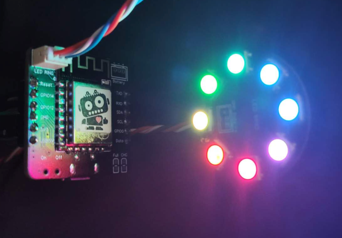

Hardware design (split into three PCBs)
Main control board + lithium battery + charging circuit
  • MCU module ESP826612E module
  • LDO drops 3.3v to power the MCU
  • TP4056X charging circuit
  • Automatic disconnect design. Inserting USB automatically disconnects battery power and switches to charging state
  • Manual switch design. Option not to use battery (no charging or power supply)
LED light source board
  • 30mm x 30mm
  • 8 WS2812 master-controlled 5050 full-color LEDs connected in series
  • Powered by main control board
  • 3D printing condenser mask
  • Make the light source and main control into a desk lamp style
Expansion interface board
  • CH340C USB UART
  • Automatically set GPIO0 to enter download mode circuit
  • I2C OLED interface, can be used as a debugging display during development
  • Connected by 2x6P pin header and main control board
  • Download the program and use it when debugging the program
  • With reset and boot keys
