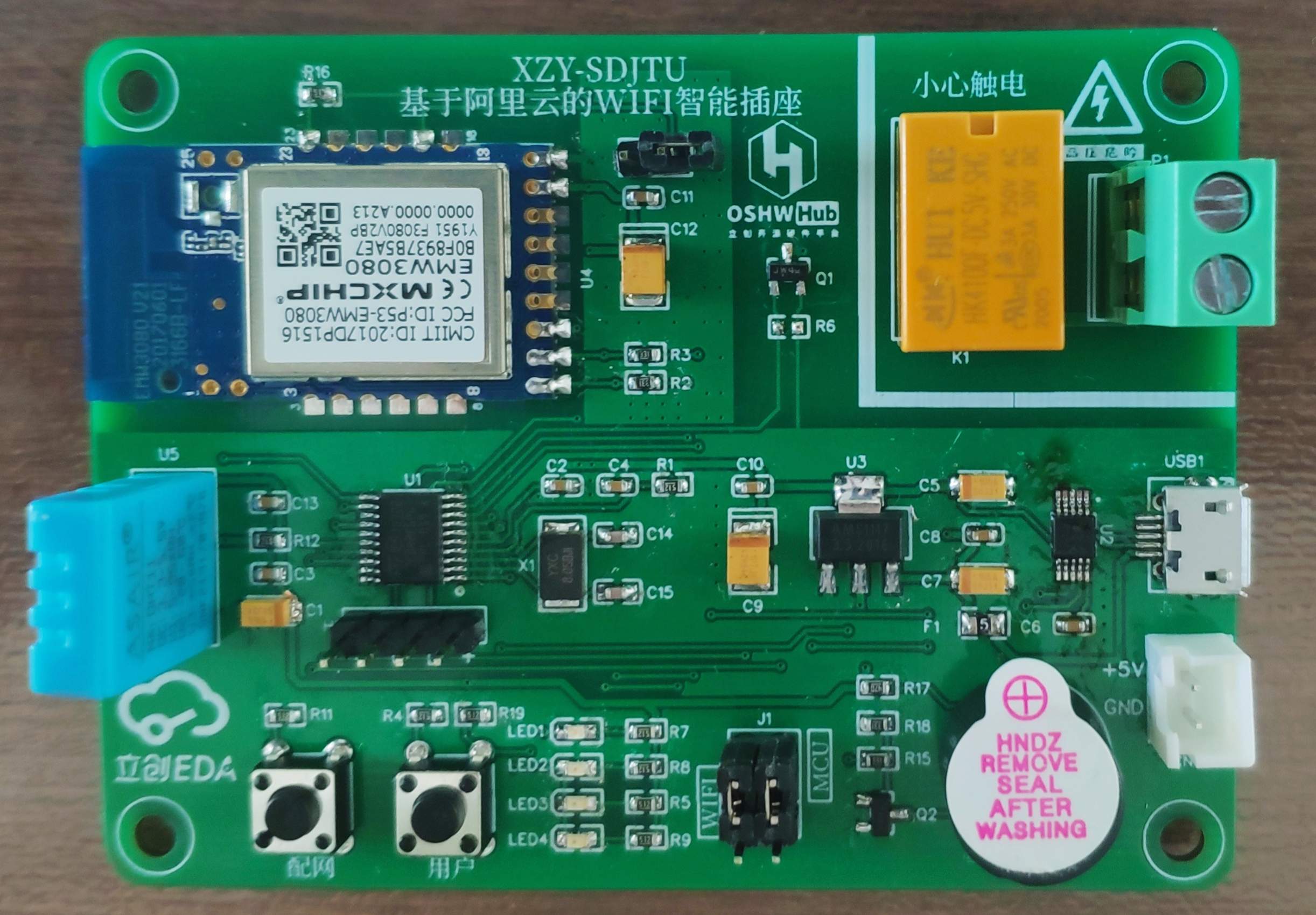

  • 11. Physical picture.

  • 1. The first car rollover. Song Gong's program was released and transplanted to the STM8S103 platform. After compilation, it was found that the code exceeded 8K, which was a major overturn! ! ! Decisively replace the STM32F042F6P6. I happen to have this film on hand. It has 32K FLASH and 4K RAM, which should be enough.
  • 2. The second rollover. The seventh pin of the CH340 chip should use +3.3V for power supply, but I used 5V. I didn’t look carefully when copying the circuit, so I preconceived it! ! ! Remember, don’t be empiric. For unused chips, you must read the manual carefully, read the manual, read the manual! ! ! Decisively cancel the new order placed last night. JLC will deduct 10 yuan, which is regarded as payment of tuition. Place a new order. The review completion time is 2020-08-14 09:39:09. I hope that the No. 16 board will arrive.
  • 3. From 8th to 17th, the debugging completed the basic functions of the switch control relay. The functions that have not yet been completed include FLASH storage data and DHT11 temperature and humidity collection, which will continue to be improved in the future. After the circuit board was welded on the 16th, the main focus was on the EMW3080 module networking configuration method. Finally, the hotspot distribution mode was adopted. The triplet data of the module was first configured through AT commands, and then the module was completed through the hotspot distribution network on the mobile phone APP. of binding.
  • 4. On the 8th-18th, the temperature and humidity collection and upload function was completed, and the relay switching logic was corrected.
