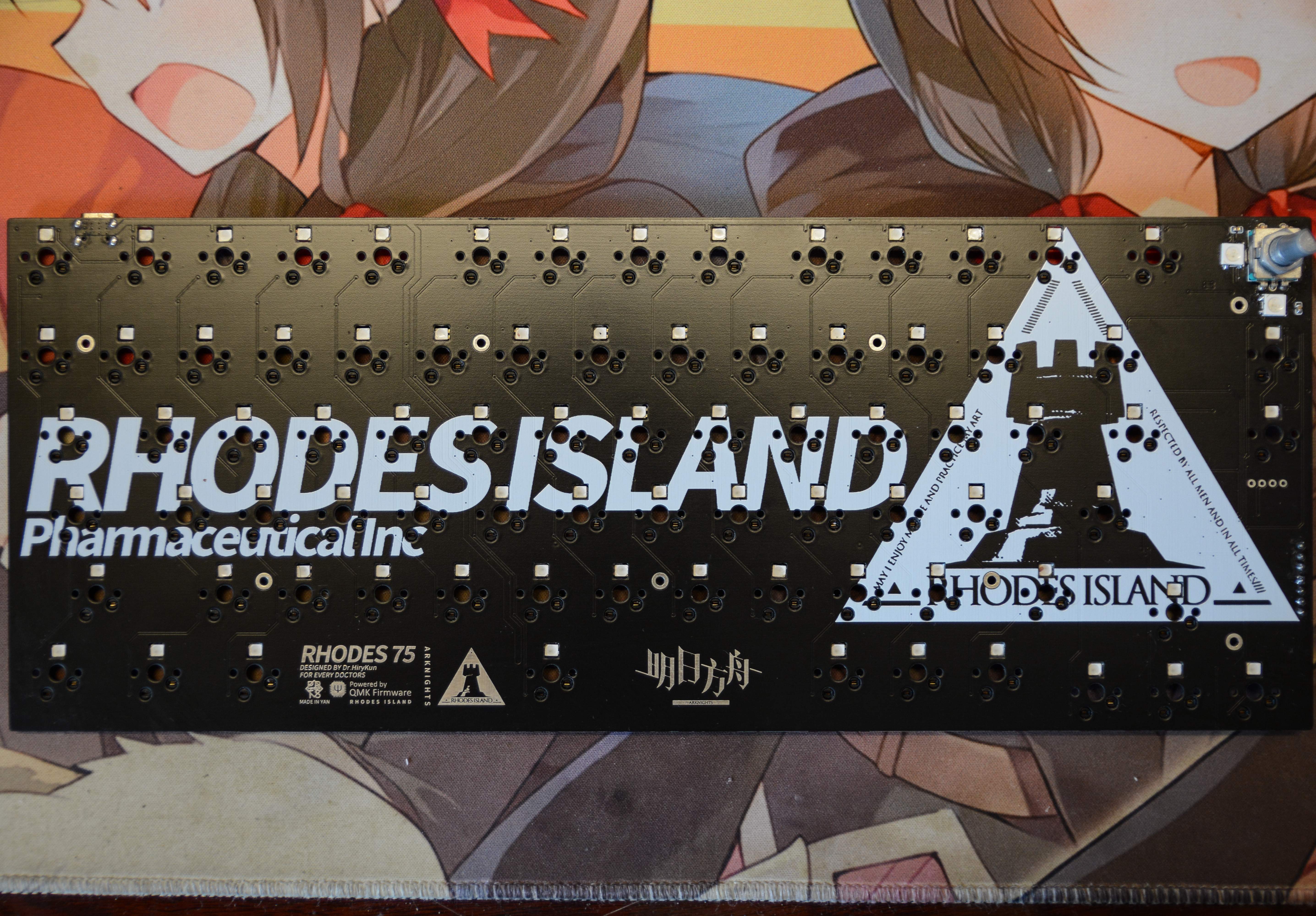

Rhode Island theme 75 is equipped with PCB, has knobs, OLED screen, full-key hot-swap, RGB, uses QMK firmware and Vial key change
! ! ! I am a high school student, and my time is limited, so I am no longer able to complete the shell (I originally planned to modify the zuoer). The attachment provides a positioning board drawing (the same size as the actual PCB). I look forward to everyone's works! ! !
Please refer to the original list in my attachment for BOM!
! ! ! There are two versions of PCB. The difference is that the LDO package is different. It is recommended to use GB package, which is easy to buy, cheap and easy to solder! ! !
! ! ! When soldering, please note that the silk screen triangle of the axis light corresponds to the VCC pin and not the GND pin! ! !
! ! ! APM32F103/STM32F103 needs to flash the BootLoader before the firmware can be flashed. This project uses SWD, so please prepare the downloader! ! !

Next are some physical pictures (because the OLED screen is not soldered, the demonstration video is covered with toilet paper)
As it says on the PCB, "FOR EVERY DOCTORS", I wish all the doctors have a good time!
