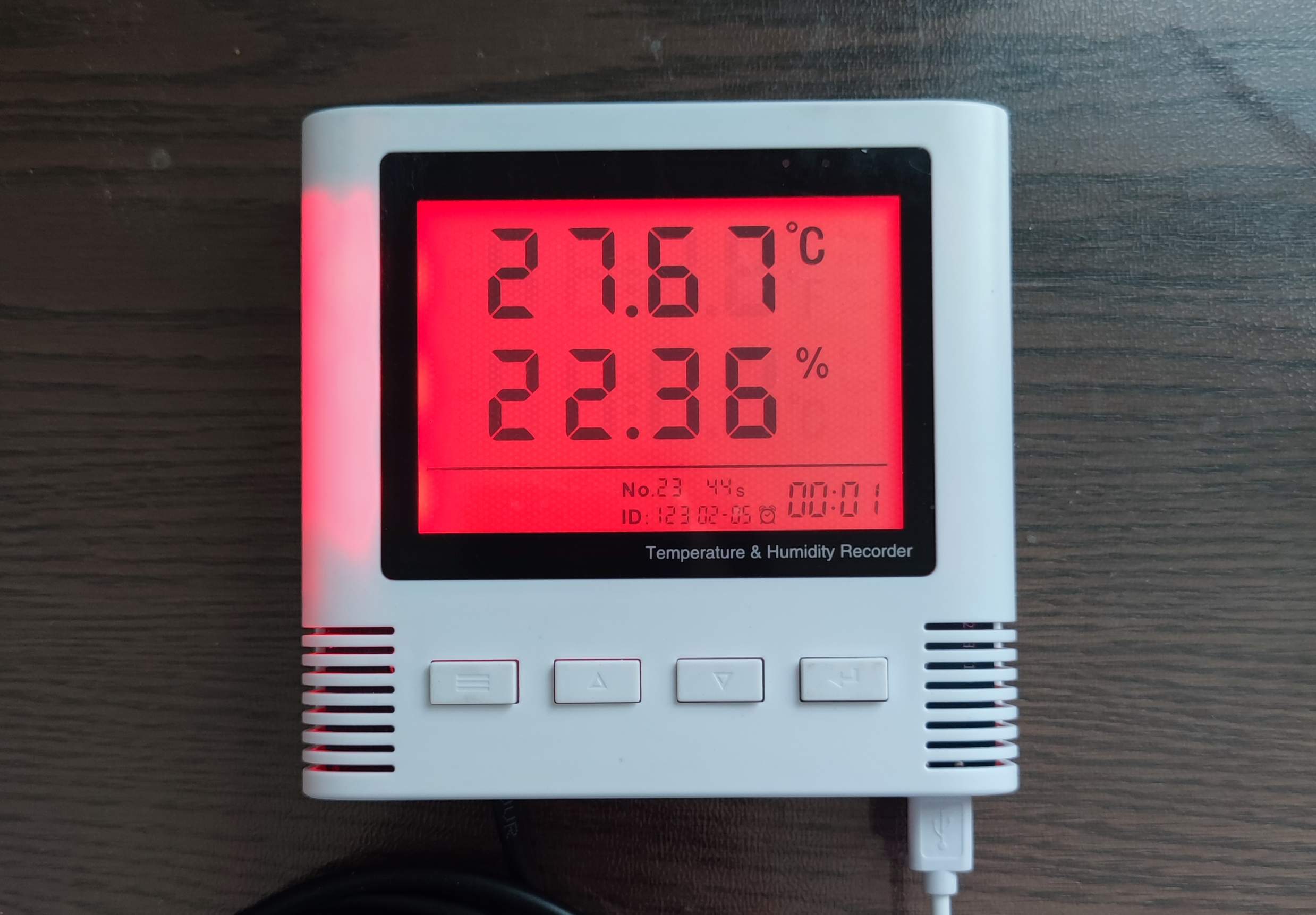

8. Segment code LCD screen.
The purpose of choosing this LCD is because it comes with a matching casing. I don’t know much about 3D printing, so I could only buy a finished common-mode casing. After adjusting it for a long time, I finally chose it. It costs 40 yuan for a set, casing + display, which is a bit expensive. I heard that it is easier to win prizes if you have a shell, so I gritted my teeth and endured it. picture.png The HT1622 is used to drive the segment code LCD screen, and the AW9364 is used as the backlight adjustment (but the debugging was not successful, so we can only wait for the future, embarrassing!)

3. Process pictures
1. Jialichuang production + SMT photos
2. Temperature and humidity display
3. Atmospheric pressure + altitude
4. Carbon dioxide + ambient light
5. TVOC display
6. Battery insert
7. Install the battery
8. Front of finished product
9. The back of the finished product
