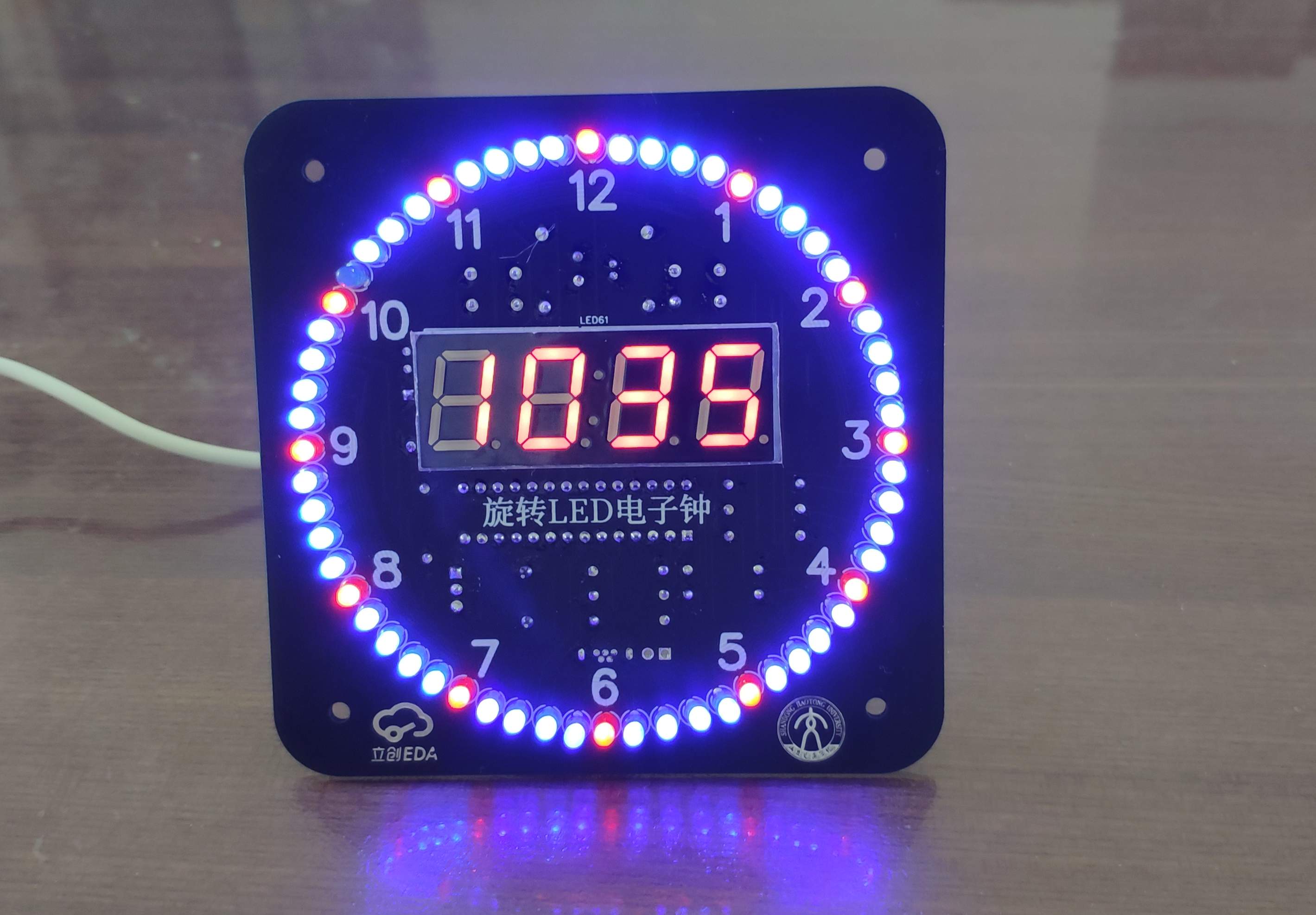

1. Rotating LED electronic clock, using STC15W408AS microcontroller and DS1302 clock chip, 60 LEDs can transform into various patterns, display temperature at the same time, and adjust the display brightness according to ambient light. 2. Two buttons, left button: switch display mode + auto-increment; right button: switch setting parameters. 3. Video from Station B https://www.bilibili.com/video/BV1U5411a7JY 4. There is a HEX file in the attachment, which you can create. 5. This project is used for students to practice electronic technology and practice welding technology. I hope you will not use it for commercial purposes, thank you! Friends who like this project, please give it a like, thank you!
