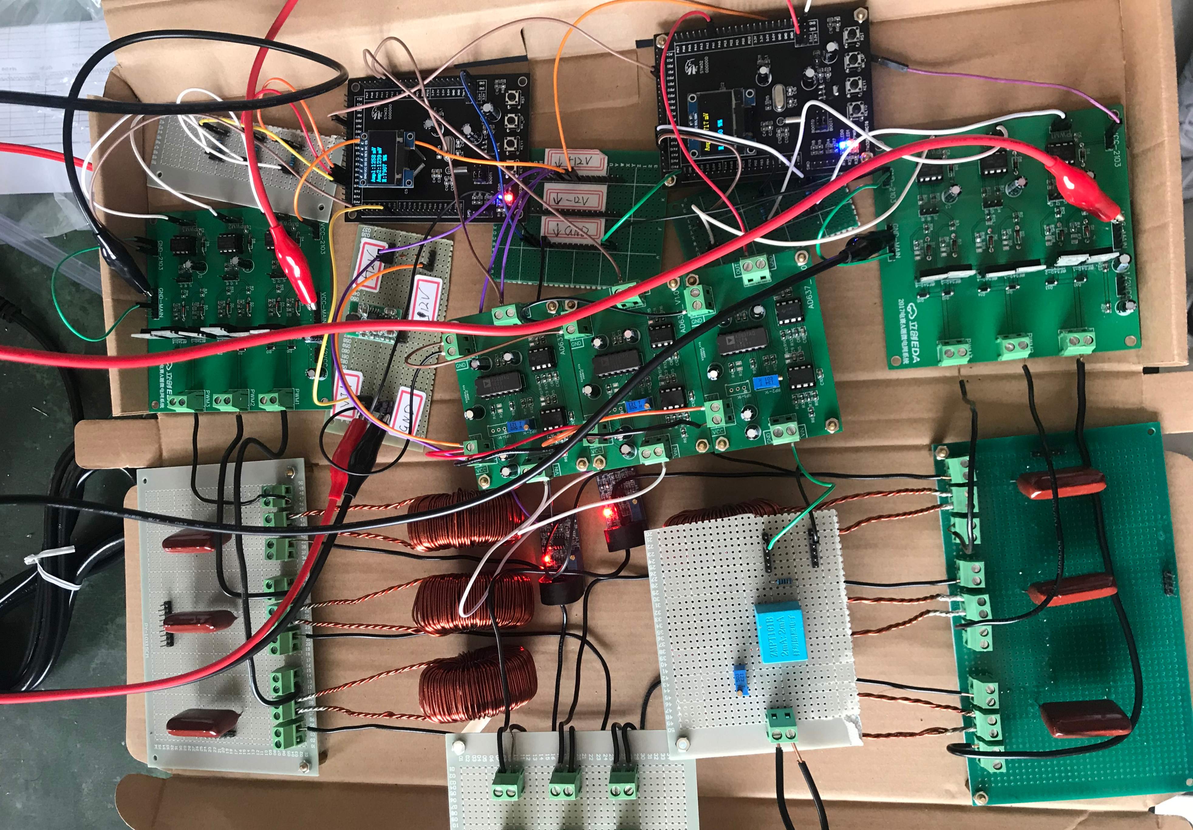

The system consists of four parts: three-phase inverter circuit, drive circuit, feedback circuit and control circuit. The system structure block diagram is shown in Figure 2. The three-phase inverter circuit uses a half-bridge inverter structure and controls the output through the opening and closing of the switch tube. The driver circuit uses the IR2103 driver chip, which can drive the PWM wave output from the microcontroller to turn the switch tube on and off. The feedback circuit is composed of current transformer, voltage transformer and AD637 chip with true effective value detection. The current transformer and voltage transformer can well isolate and reduce the output AC power. The microcontroller reads the output value of AD637 to adjust the degree. adjustment. The control circuit uses the most popular STM32 series microcontroller STM32F103C8T6 as the control core, which includes key control, ADC, OLED display and other functions.  image.png

Solution analysis: In order to simplify the system design as much as possible and reduce the hardware complexity, the system adopts the second solution. image.png

Solution analysis: Since the communication method is used between the microcontroller and the microcontroller, asynchronous communication will lead to asynchronous waveforms. Therefore, it is necessary to reduce the resource occupation of the microcontroller, so scheme one is adopted. image.png

2.Program flow chart *** image.png ***
