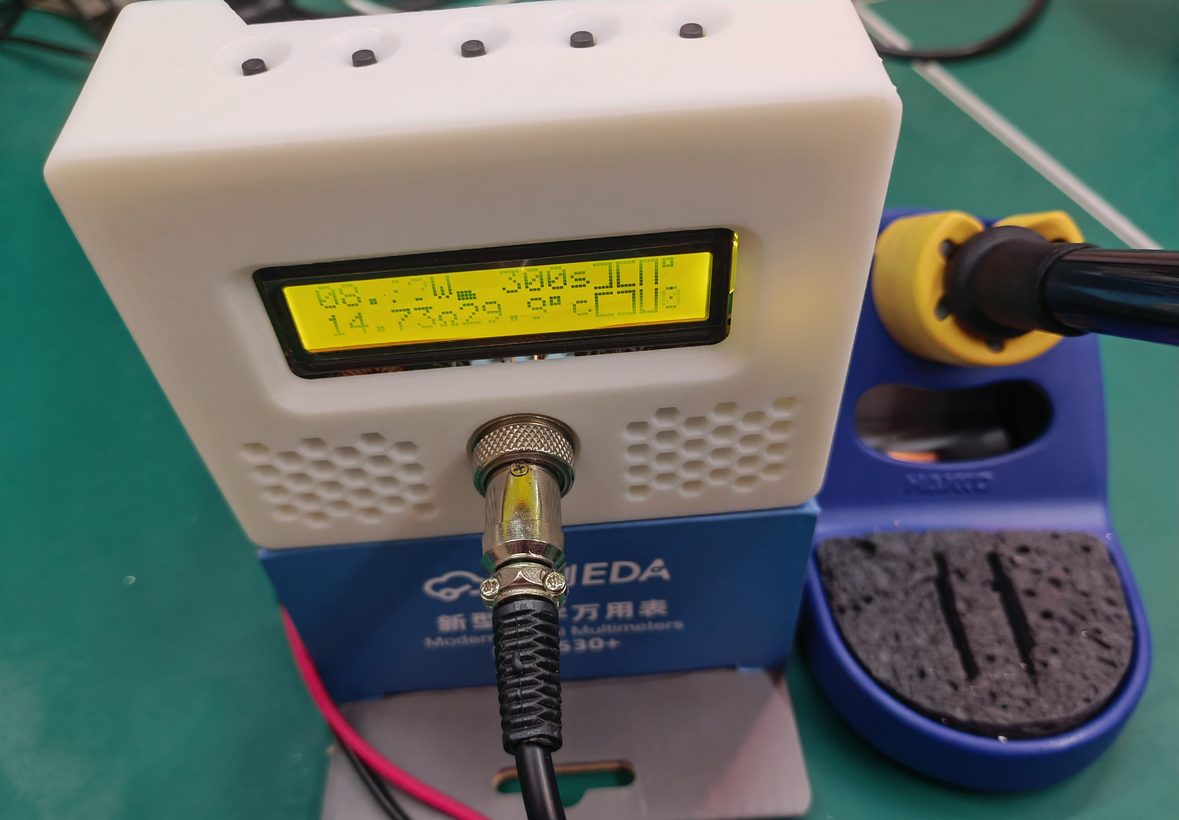

4. Physical pictures
C19 has been corrected in the production files, so you can use it with confidence. Because the stock of electrolytic capacitors is insufficient, the remaining capacitors are soldered to important positions. It has little impact because several of them are connected in parallel. D3 also does not have SS56, but has two SS36s on top. Pay attention to the 12V fan interface. Because we do not intend to PWM the screen backlight, only the fan part is welded.
As for the installation diagram, the shell here is too thick, so the nut cannot be installed on the aviation seat. The model has been corrected, and the 5mm wall thickness is a bit thick. In the future, a thinner shell will be redesigned to reduce 3D printing costs. If it is PLA, it is recommended to use this thickness, and the filling degree can be reduced. R26, R27, and C10 are reserved for STM8. No welding is required for non-STM8.
The air duct design is specially reserved at the bottom, and the heating element is placed in one corner.
(If you are pursuing efficiency, you can replace the inductor with an iron-silicon-aluminum magnetic ring of the same size and specifications, which has a larger rated current and lower iron loss.)
The other side is the op amp, thermal sensor, and buzzer to ensure that it is not disturbed by temperature as much as possible while allowing the buzzer sound to come out through the grid.
