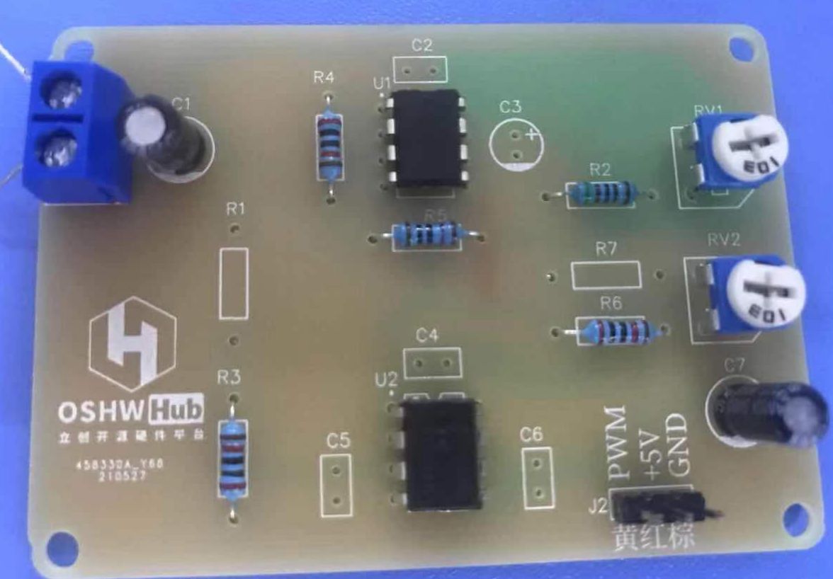

I don’t need to elaborate on what it is used for and how to use it. Taobao has a lot of similar products.
Function: Output 50Hz pulse, pulse width adjustable from 0.5ms to 2.5ms.
working principle
The first part is actually the same model as the LM358 breathing light circuit.
U1.2 and its peripheral components form a low-pass filter, and the op amp may be used as a constant current source to charge and discharge the capacitor, so the triangle wave will be straighter than the oscillating triangle wave of NE555.
RV1 adjusts the charge and discharge current, thereby changing the triangular wave frequency.
U1.1 and peripheral components form a non-inverting Schmitt trigger, and the trigger level is the divided voltage of R4 and R5.
The second part is a comparison circuit
The second part is to compare the triangle wave with a reference voltage to generate PWM.
The waveform will be added later. Please refer to SPWM for the specific implementation process.
Debugging results
Note that some SMD components are used and soldered on the back of the actual product. In reality, there are components, not without soldering.
