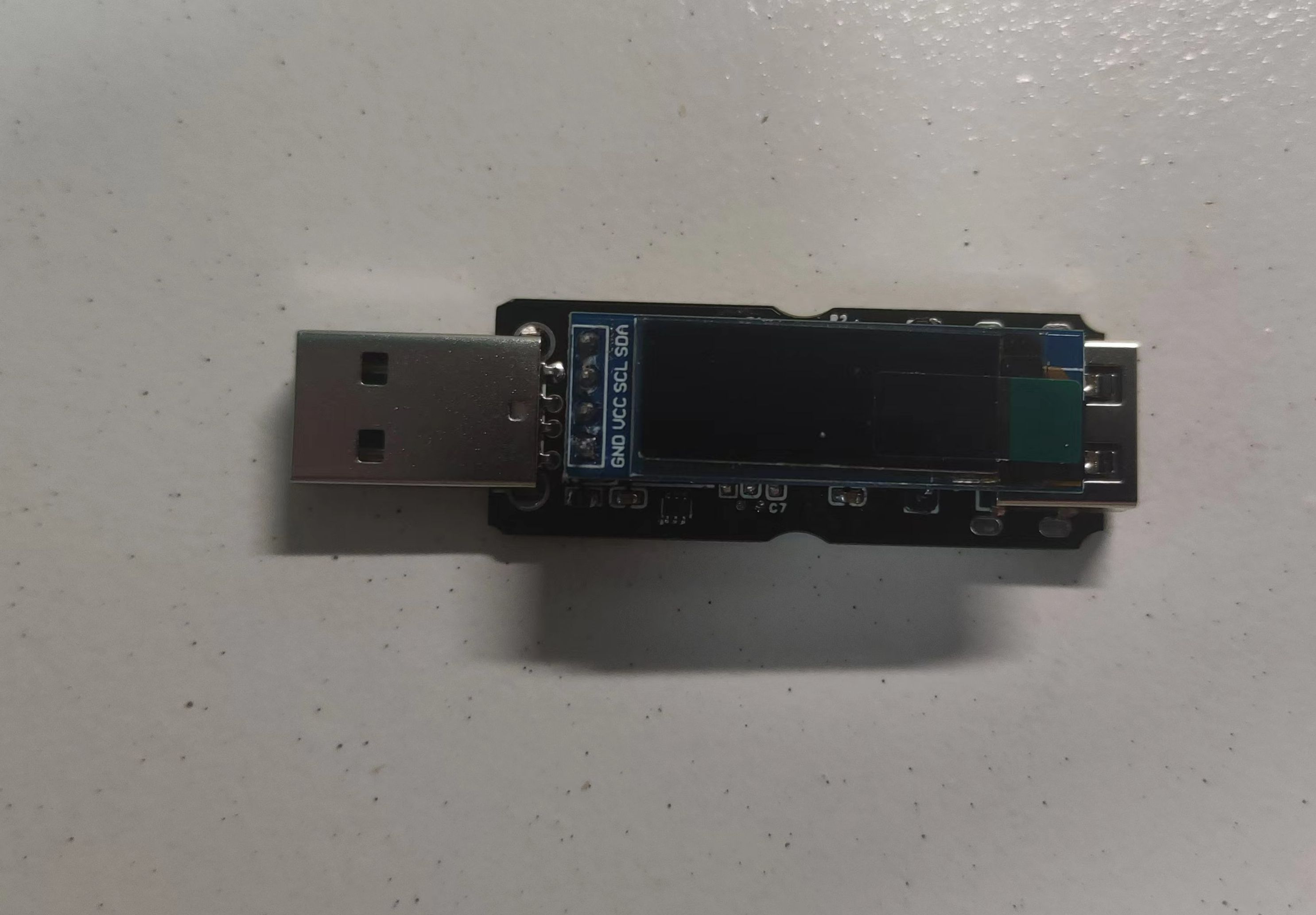

* 1. Project function introduction:
A USB ammeter made based on the National Technology N32G430C8L7 chip + INA199, with an accuracy of 1%. It can check the voltage, current and power when the USB is working.
*2. The project attributes
are made public for the first time and are open source.
*3. The open source agreement
cannot be used commercially without my permission.
*4. Hardware part: Main
control part :
68IxPyGv52JrWGxTVdOYHywpzaWSMGvIllt67dRx.pngNote: According to the official schematic, pin 1 needs to be connected to an external 4.7uf capacitor. Use software IIC
sampling circuit. The current sampling
B4BIzmgEfU2ZAnNWiwWA37bwXjRg7EdGK7c0Xann.pngchip is INA199A1 26V, bidirectional, zero drift, low side/high side, voltage output shunt monitor (accuracy is OK)
*5. Software part:
Keil development: Note that the pin source code of IIC is in the attachment
