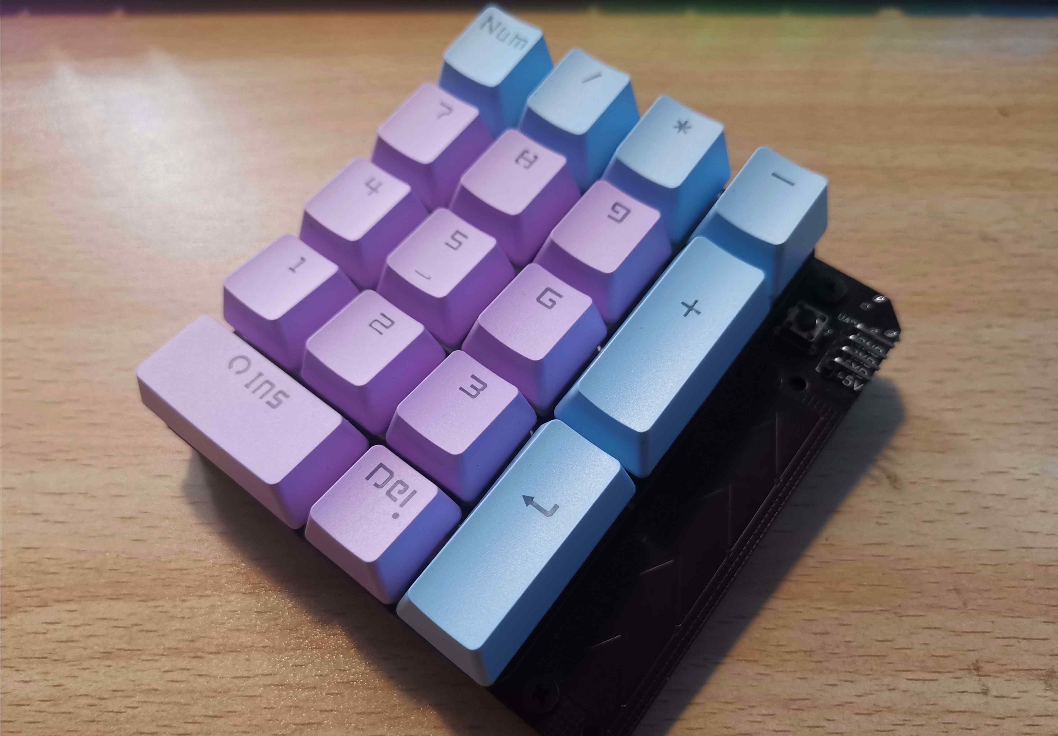

The most beggar 17-key + touch strip mechanical keyboard
After consulting Qinheng engineers, I learned that the CH551G has been discontinued, and the CH552G that is still in production is fully compatible with the program. You can consider this when buying chips.
By the way, someone bought the CH551G without a USB boot program and reported to me that it could not be burned. Here I will directly post a link to the one I bought before that worked.
I will not vouch for the store. In Huaqiangbei Electronic City, if a store does not have this chip, it will ship the order to the stall next door. I don’t know if the chip that cannot be programmed will be sold out.
Kit sales link: http://aliurl.cn/299o2p
Function description:
light:
  • When in lock: 1Hz breathing
  • When not locked: 0.5Hz breathing
button:
  • Due to the limited number of IOs, the keys conflict and simultaneous presses cannot be recognized, but there is no conflict locally (2, 4, 5, 6, 8)
  • When it is not num lock: the minus sign key code will be replaced by backspace to facilitate accounting entry.
touch:
  • The touch strip has a 90Hz sampling rate
  • Automatic zeroing algorithm at startup to avoid capacitance differences between washed and unwashed plates
  • When the touch bar is in num lock: slide the volume adjustment, click in the middle to play/pause, press up and down to switch music
  • When it is not num lock: slide to become the mouse wheel, click in the middle to open the calculator, press up and down to adjust the brightness [valid for notebooks or all-in-one computers]
  • Please see the attached video for specific touch operations.
other:
  • Onboard STC programming port, UART and buttons are multiplexed, with automatic power-on function (multiplexed with LED driver mos tube), but the program is not adapted yet.
  • The USB port is drawn out at a 45° angle to the upper right, with a unified design language from the previous generation.
  • It adopts micro usb interface and consumes redundant micro cables. DIYers who want type C can modify it by themselves.
cost:
  • PCB sizes are all within 10*10cm
  • The electronic components are simplified, except for the microcontroller, buttons and LEDs, there are only 1 field effect transistor, 2 resistors, 3 capacitors and 4 diodes.
  • Capacitive touch buttons are free because they are integrated on the PCB~~~ (~ ̄▽ ̄)~

Appreciation of physical disassembly: (Why disassembly? Because the shooting and production process was missed)
The left is the main board and the right is the base plate. Just like the previous one, we use M3 nuts to connect them. The screws do not protrude from the base plate and are not afraid of scratching the fabric.
Note that the screws are inserted under the positioning plate first and then the shaft body is welded to fix the positioning plate.
The bottom plate pattern can be changed at will, but it has no function anyway.
The USB port on the bottom panel is slotted to make the keyboard thinner.
Take a photo with the current main keyboard
