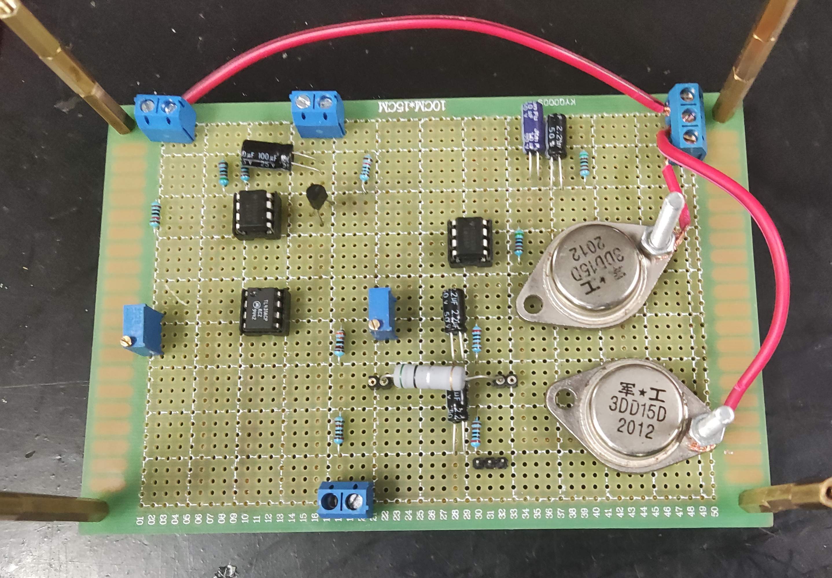

3.2 Constant current module** **
                 Figure 5 Constant current module** **
The constant current module mainly uses two high-power **** transistors to amplify the current, and adds positive feedback to ensure that the current is constant. ** **
3.3 Overvoltage protection module** **
Figure 6 Overvoltage protection module** **
The core of overvoltage protection is an LM358 operational amplifier with an adjustable resistor connected to the positive terminal and a TL431 used for voltage stabilization. The voltage changes according to changes in the resistance and input voltage. The negative terminal is a voltage regulator tube, and the stable voltage is around 2.5v. When the negative terminal is greater than the positive terminal, a low level is output, and the triode does not work. The circuit is closed. When the positive terminal is greater than the negative terminal, a high level is output, and the triode starts to work.

 4.1.2**** Physical **** board test ** **
After testing based on **** actual objects, two problems were found ** **
1. When measuring voltage, the voltage is too high, and the ADC sampling range should be less than 3.3v. To solve this problem, we connected a transistor in series, changed a sampling point, and reduced the voltage.
2. The voltage at both ends of the electronic load changes too much, causing the test to be inaccurate. The ADC sampling value keeps changing. To solve this problem, we have adopted three solutions. One is to add a filter capacitor so that the voltage at both ends of the resistor changes with the power input. The terminal changes without obvious fluctuations. Secondly, in order to avoid the resistance change caused by the heating of the sampling resistor when passing a large current and affecting the output current, this circuit connects a high-power spring-type sampling resistor to the circuit. Thirdly, in order to reduce the heat caused by the transistor. Oscillation, multiple transistors are connected in parallel to increase heat dissipation, which can improve the stability of the power supply output current.
