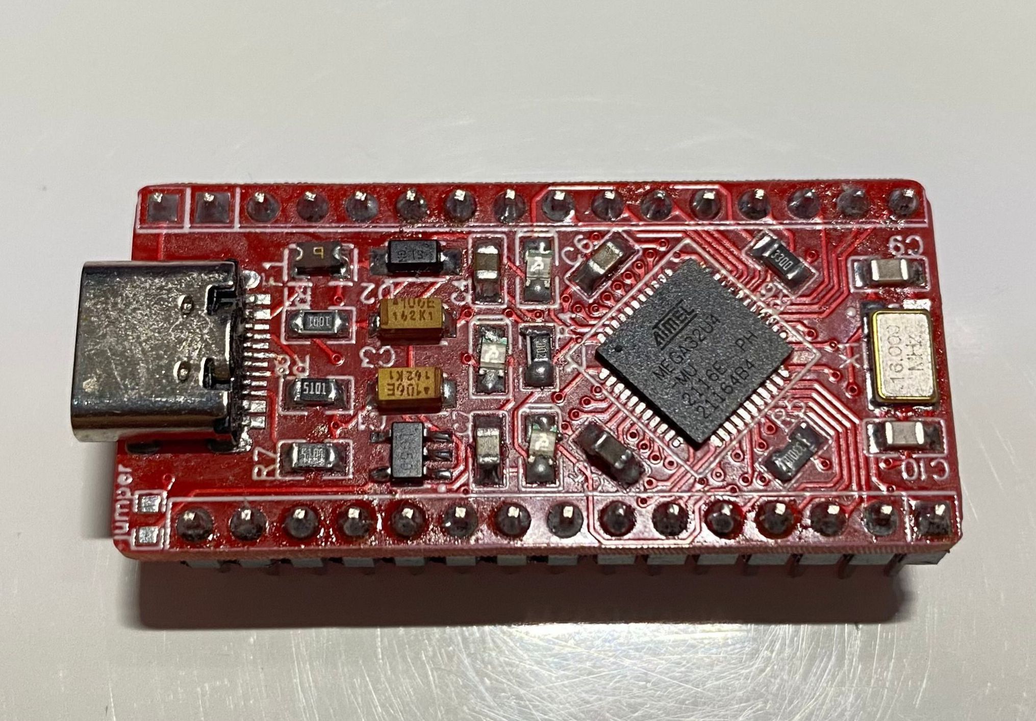

Homemade Atmega32u4 core board.
The core functions are consistent with ProMicro or Arduino Leonardo, and have more IO and greater output power.
This project is a fully GPIO enhanced version, using QFP-44 packaging, with a total of 26 GPIO interfaces , 1 VCC interface, 1 VBUS interface, 2 GND interfaces, 1 Reset interface, 1 Data+ interface, 1 Data- interface, 1 RAW power receiving interface.
Jumper is a jumper, which can be connected to a 0Ω resistor or short-circuited so that the chip and peripheral circuits are directly powered by VBUS .
B1, B2, and B3 are CLK, MOSI, and MISO interfaces in order, used for ISP programming.
You need to burn Arduino BootLoader to ATmega32u4 before use. See the video for details: https://www.bilibili.com/video/BV1sQ4y1a7Mj
