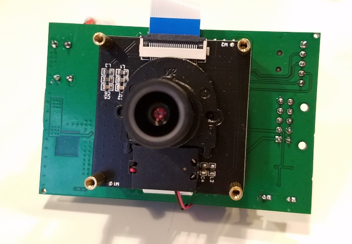

Briefly introduce the work: Combining low-power AI chips and mobile networks, the person/object detection model is deployed on the device side to achieve the effects of lower power consumption, real-time response, and traffic saving.
1. Work details: This work implements a camera based on an AI chip that recognizes objects on the device, takes photos, and uploads them to the cloud;
2. Describe the challenges faced by the work and the problems it solves: This work is aimed at monitoring needs in environments without Ethernet and WIFI, such as wild fish ponds, farms, etc.; in this environment, cellular networks need to be used for data transmission. , if the amount of data is not controlled, high usage fees may be incurred; running the AI recognition model on the device can capture key information while maximizing traffic savings.
3. Describe the key points involved in the hardware and software parts of the work: 1. The main control chip uses Kanzhi K210, the camera OV7740, and the data transmission uses 4G module EC20 or 2G module SIM800C; 2. The device runs FreeRTOS + LWIP and is driven by PPPOS 4G module, the yolov2-tiny model will be loaded after the system is started, and connected to the back-end server through the MQTT protocol; the camera thread reads the image information, processes it and sends it to the K210's built-in convolutional neural network accelerator to obtain the prediction of yolov2-tiny The results, if there are results exceeding a predetermined classification threshold, are sent to the backend via the MQTT protocol. 3. The back-end server is developed based on Thingsboard to implement image information display and device firmware OTA functions.
4. List of materials for the work: Please refer to the BOM for the main control circuit board. In addition, you also need the OV7740 camera module and 4G/2G module;
5. Upload pictures of works;
* 6. Demonstrate your work and record it as a video for upload; see the attachment for the video
