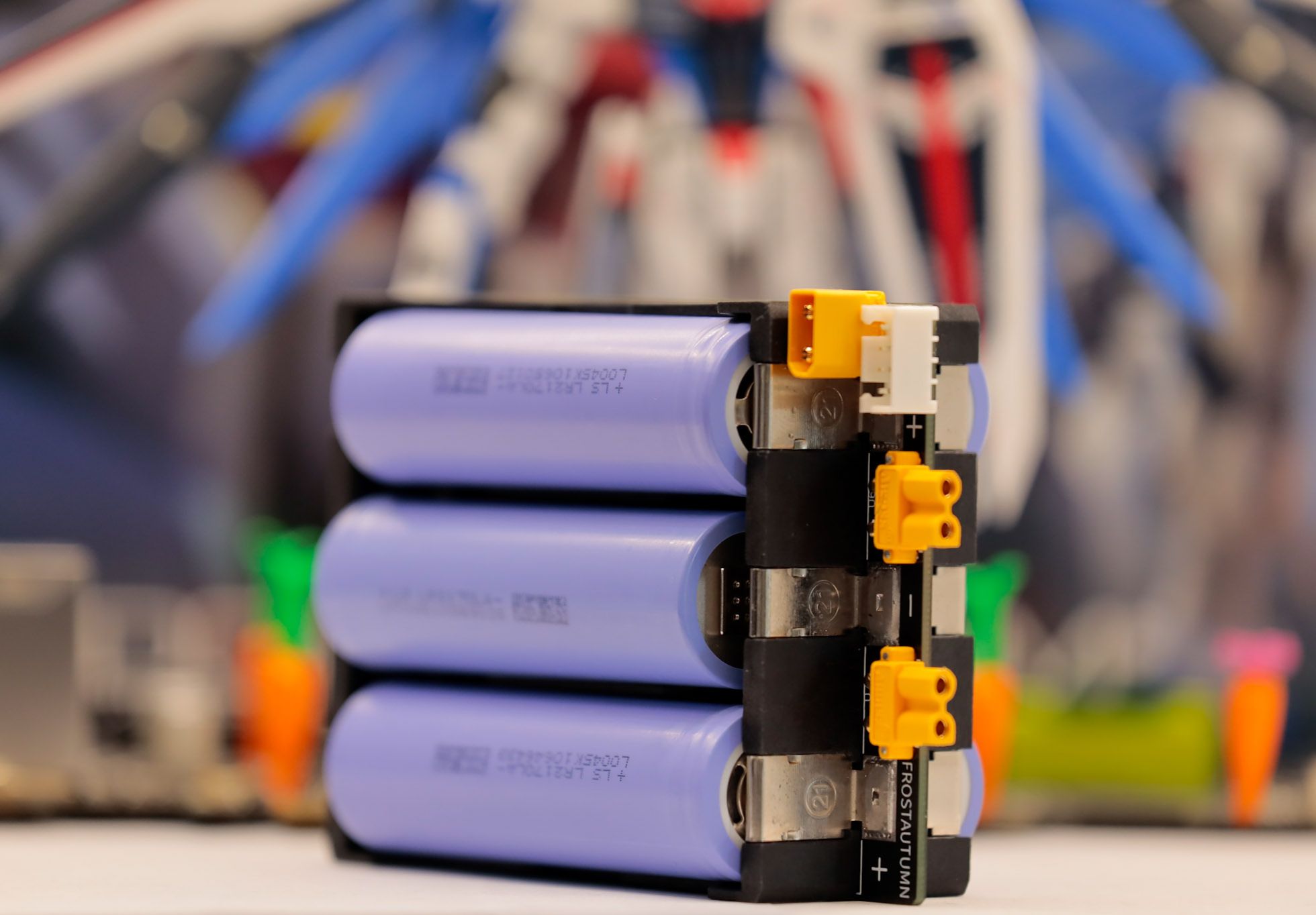

The design is hellish! ! !
The schematic is useless (funny) and the PCB is all done by hand. . . .
So just look at the PCB directly
Parameters: Voltage: 11.1V Current: 0-10A Maximum power: 120W
B station production process and video https://www.bilibili.com/video/BV16a411X7j5?share_source=copy_web
B- and P- are the interfaces for connecting the protection board. If you do not use the protection board, please short-circuit it. Otherwise, if the xt30 has no output, you can also install a fuse.
Balance charging can be used with or without a protective plate installed (details)
Sorry for my poor welding skills. . .
Adding an xt30 to the protective board pad makes it easy to switch modes and disassemble and install the protective board.
The protective board of "Magic Reform". . B- and P- correspond to the ones on the PCB and the balance lines can also be connected in order.
With the protective board installed, it looks like it can be made into a casing.
2022.7.13 The latest progress of 3D printing drawings has been completed. It cannot be verified because the printer has not arrived, so stay tuned (dog head)
