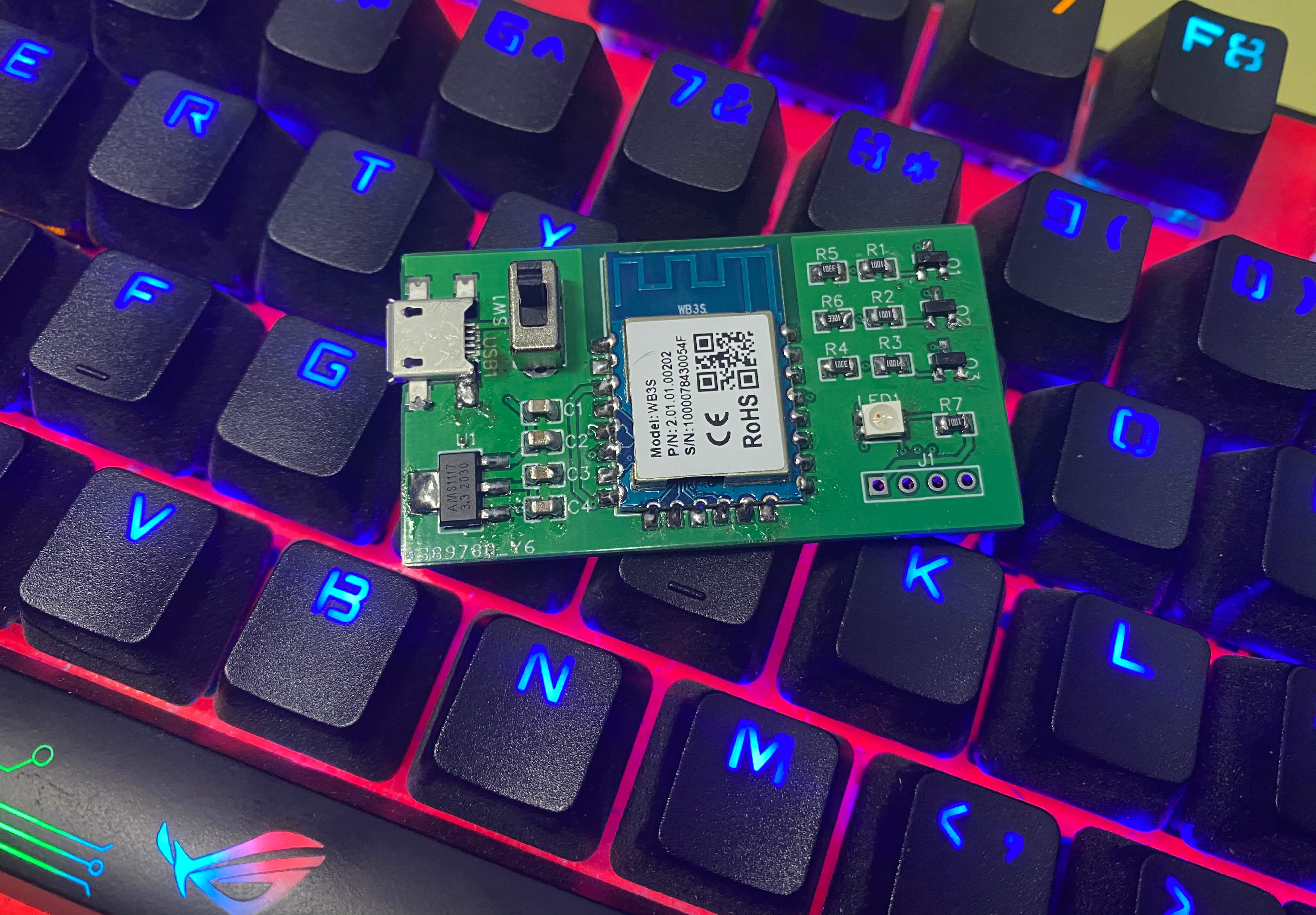

The full-color IoT small lamp based on the Tuya WR3 WIFI module can be controlled online using the mobile APP.
The mobile APP controls color, brightness and contrast. Onboard micro USB power supply interface; reserved 5V light strip interface, the light strip can be expanded. It can be connected to smart speakers such as Tmall Genie for control.
1. Register and log in to Tuya Smart APP, and select the Add Device button in the upper right corner; 2. Select "Auto Search" and configure the phone to connect to WiFi; 3. Perform the "on-off-on-off-on" operation for the night light to ensure that the light Enter the flashing state; 4. Wait for network configuration. If successful, you can open the APP interface for operation.
5. Effect display As long as the module is connected to the Internet, no matter where you are, you can control the various states of the light from the APP.
Debugging successful!
