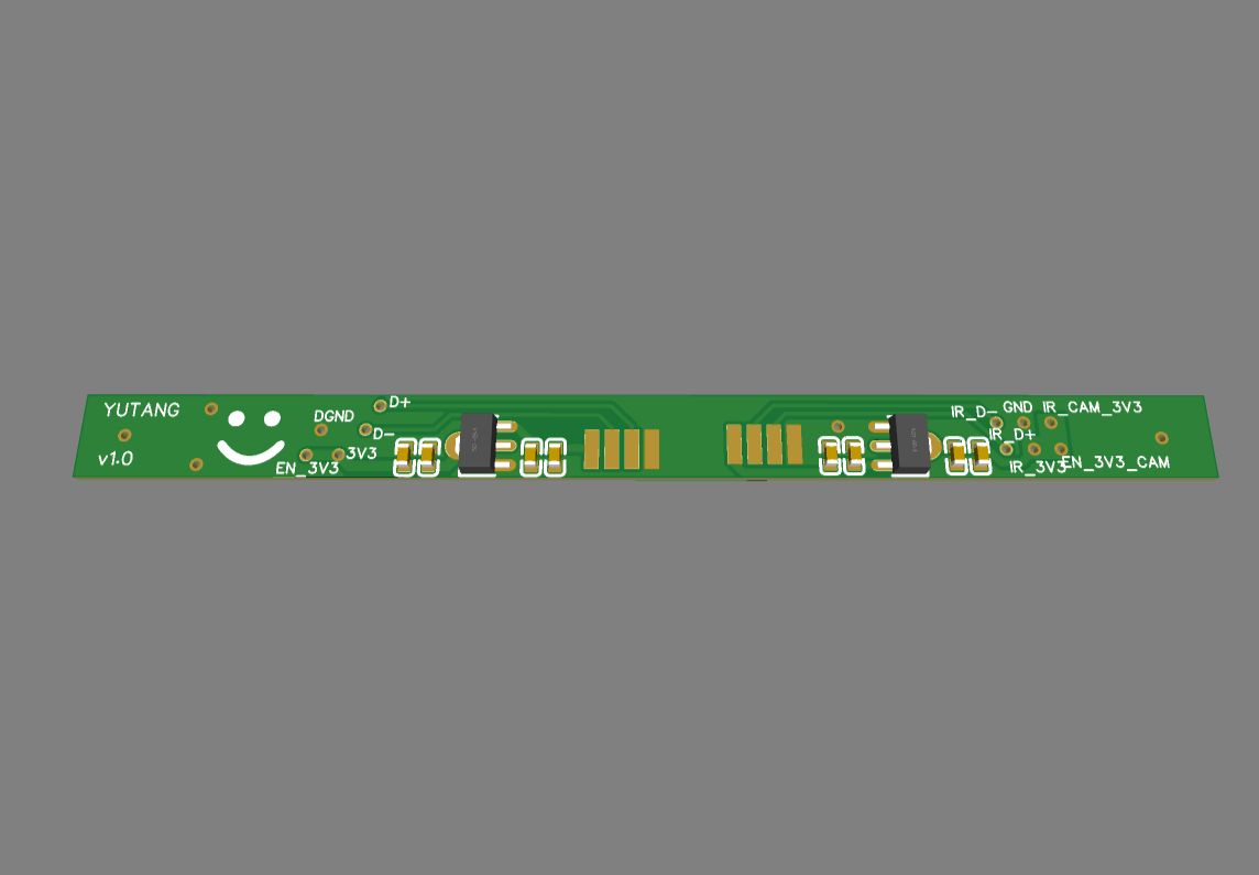

Solder through the via pad on the back, and make the board as thin as possible to prevent empty soldering.
The USB pads drawn out are from left to right, red, white, green and black 5V D- D+ GND
Please try your best to modify it. If it is not done well, this is posted to provide a back welding solution. The hole position is correct and can be used.
