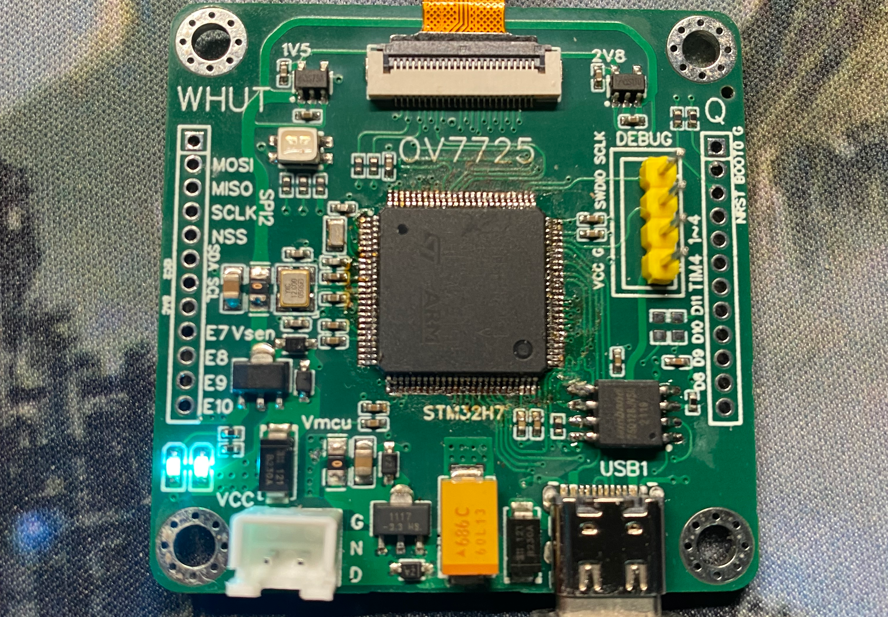

OPENMV4 four-layer board
Drawing a development board that is cheap and can meet basic development needs actually has nothing to do with openmv, but everyone seems to be familiar with it. . You can flash that firmware, it’s open source anyway, right hhh, or writing it yourself is not a bad idea. Recently, I found a job and I’m bored. I’m playing with H7 for image processing. It’s easier to calculate. It’s equipped with a serial port screen or an M4 monitor. The interaction is pretty good. The drawings are relatively standard. I think (I think) most of the wiring pins are of equal length and are 2.0mm, because most of me prefer to use the bottom board. . . I plan to get an LCD screen and ESP32 on the bottom board, and then replace some of the pins with 2.54 or a white bayonet interface that supports OV5640 (high pixels and low frame rate) and OV7725 (low pixels and high frame rate). Here are a few pictures. . .
-----------------------------------------------Project V1.0 -------------------------------------------------- Board It looks like this. IMG_3219.JPG The frame rate of OV5640 is like this. 4IU`VZ2SWS`{_{RHCO_%Q`1.png The frame rate of OV7725 is like this. `130JE)5~SALZOGQEW2%W02.png It supports MT9V043 in the back (grayscale, no verification). If you make the board yourself, you don’t need plug-ins, tantalum capacitors, or a 32k crystal oscillator. It costs more than 100. Flash verification. Oh, get the matching capacitor of this crystal oscillator. Wrong, please read the next version.
--------------------------------Project V1.2-------------- -------------------------- Then it was verified that a button was added after the first version to realize the switching of dfu in the board. . . . It is expected to be around December 20th. I will try to send materials and patches. Then I will write down my feelings/xyx. By the way, there are also ordinary prints, which are a bit stuck. In the end, they are all problems. I will still use professional offline prints if there are problems. Comments below.
