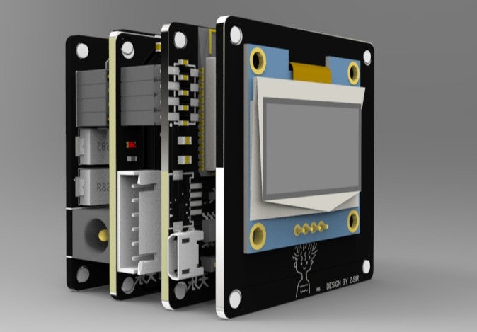

*4. Hardware part
The circuit part of this design was all completed by Lichuang EDA. CAD and Solidworks were used for drawing, Keyshot was used for rendering, Windows version was used for video editing, FScature was used for screen recording software, and XMind was used for mind mapping.
1 Supported chips: HK32F103C8t6 (CBT6), STM32F103C8T6 (CBT6), STM32F401CCU6 (QFN package)
2 Pinout: TIM1(CH1 CH2), TIM2 TIM3(CH1 CH2) TIM4(CH1 CH2) PA4 PA5 two ADC leads out
3 The onboard ESP32-S2 serves as a wireless communication module and can be connected using low-power Bluetooth or WIFI. The ESP32 communicates with the main control serial port.
4 By default, TB6612 is used as the driver chip to notify the two encoder motors, and 74LV245 is used instead of the optocoupler isolation chip.
5 Onboard MPU6050, length and width design is 48*48mm, compact size
6 Lead out the 3-way Wanbao brushless motor interface (this motor has a built-in driver) and share the drive signal with the reduction motor. When using it, pay attention to the duplication of ports.
7 ESP32 integrates one-click download circuit, HK32 uses CH340E serial port chip (this chip does not have one-click download function), HK32 reserves SW debugging port
8 ESP32 and HK32 each reserve an LED status indicator.
9 ESP32 and HK32 each reserve a normal button and a reset button.
10 0.96-inch OLED displays MPU6050 attitude data and encoder data in real time, and simultaneously displays PID parameters, voltage and other data
11 LM2596 is used as the 5V voltage stabilizing component, XL4015 is used as the motor-specific voltage stabilizing component, and the AMS1117 linear voltage stabilizing component supplies power for HK32 and ESP32
12 The power input can be connected using DC005 input or ordinary 2P terminal block.
