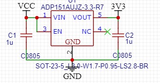

Power supply: Micro USB power supply, the power supply voltage is 5V, and ADI's ADP151AUJZ-3.3-R7 is used for step-down conversion. The ADP151 is an ultralow noise, low dropout linear regulator that operates from 2.2 V to 5.5 V and delivers up to 200 mA of output current. In the input and output parts, 1UF capacitors in 0805 packages are used for rectification, and the official recommended circuit is used:

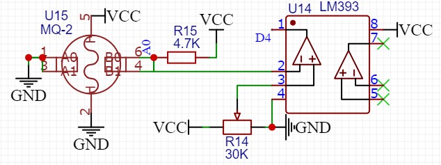

CO detection sensor: Use the MQ-7B gas sensor manufactured by Winsen. The gas-sensitive material used in the MQ-7B gas sensor is tin dioxide (SnO2) with low conductivity in clean air. The high and low temperature cycle detection method is used to detect carbon monoxide. The conductivity of the sensor increases as the concentration of carbon monoxide gas in the air increases, and the content can be easily detected through the MCU.

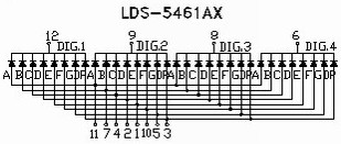

Four-digit digital tube: Use the four-digit digital tube model FJ5461AS, the manufacturer is ReliaPro, and the common cathode four-digit digital tube.
FhUowh49fa9dMiE8h8bHKJhLOp-8

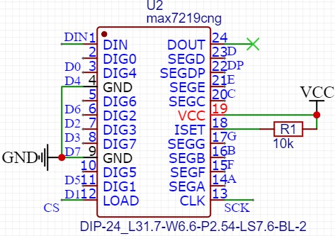

Digital tube driver chip: This design uses the MAX7219 driver chip. MAX7219 is a multi-bit LED display driver launched by the American MAXIM company. It uses a 3-wire serial interface to transmit data and can be directly connected to the microcontroller interface. Users can easily modify its internal parameters. To achieve multi-digit LED display. It contains hardware dynamic scanning circuit, BCD decoder, segment driver and bit driver. The connection schematic diagram is shown in the figure:

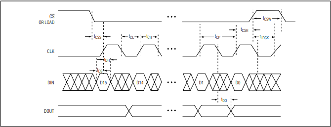

The software part is relatively simple. You only need to follow the communication timing of MAX7219 in the chip manual and send the value to be displayed. The following picture is the MAX7219 timing diagram:

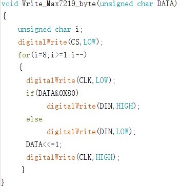

Follow the diagram and follow the steps in the arduino IDE to pull up and down the corresponding PIN. The picture shows a sub-function for writing data:

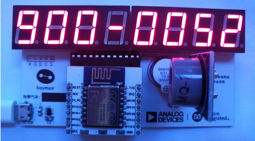

Actual picture: front

A simple hands-on training project with relatively low difficulty. Basically, no problems have been encountered. It should be noted that the sensor needs 60 seconds to warm up when working. It will heat up during normal working hours. Don’t worry, when using it Need to be as close as possible to the likely source to provide better detection.
