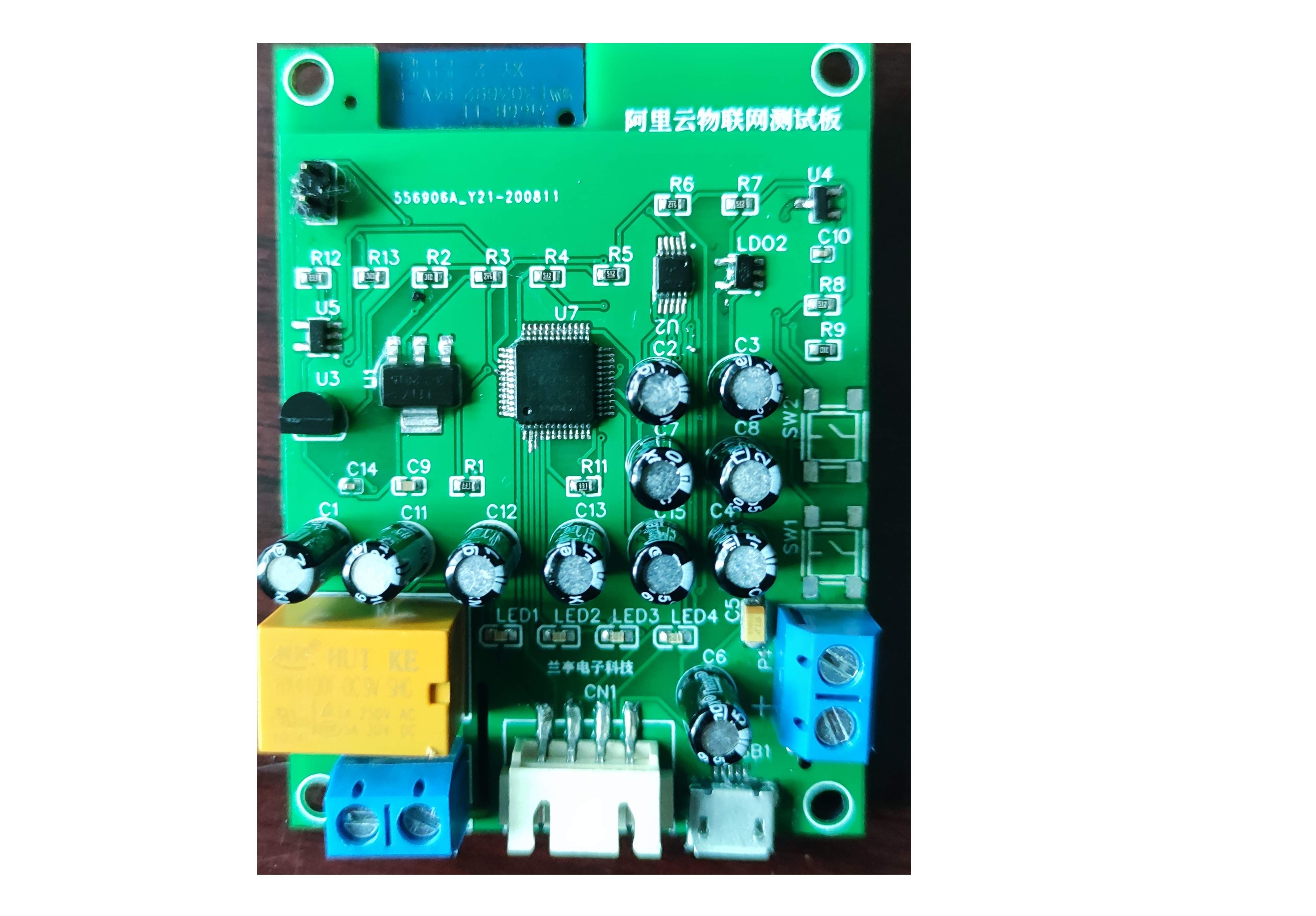

This project uses the "Qingke emw3080" wifi module. When drawing the wifi module, please read the data manual and remember to leave space around the antenna. The best ones have windows underneath the adventure. My approach is to design the wifi module on the back, firstly, to reduce the board area, and at the same time, open a window at the antenna to prevent affecting the signal.QQ screenshot 20200813174357.png

Issues needing attention in PCB drawing
1. Do not lay copper on the strong current part. Pay attention to the safe distance between strong current and strong current, strong current and weak current (try to 3mm, consider trenching if it is lower than 2mm, but the PCB strength issue must be considered); (This is very important)
2. It is recommended to use terminals when the relay is connected to an external 220V. It is not recommended to use pin holes. The wire diameter from the relay to the terminal should be thick; (This is very important. Generally, the wire width between the relay and the terminal should be set above 1.0.)
3. Place the terminal blocks and microUSB on the edge of the board, otherwise it will be difficult to wire them. You can use 3D preview;
4. The button is too close to the high voltage, and the button is in the middle of the board, making it difficult to press;
5. The power supply must filter the filter capacitor first and then to the microcontroller/WiFi module; (This is very important. The filter capacitor must be filtered first and then to the chip. Otherwise, it will cause unnecessary trouble, such as unstable command execution)
6. WIFI will generate heat when working properly, so pay attention to the heat dissipation design; (if the funds are available, you can stick a heat sink on the back and then lead out the antenna. 3080 has an external antenna version)
7. A clear area is required below the WIFI antenna, and slotting is best; (such as PCB diagram)
8. If there is a plastic mold, you should pay attention to the size of the mold space when selecting components. (It is recommended that after designing the board, you can design the 3D printing mold and print the shell on a certain store; you can also find the finished shell and then design the PCB according to the size of the shell)
PCB component welding problems
Newbies are advised to place an STM order (SMT). Don’t be afraid of spending money and weld it yourself. 9 out of 10 welds will cost 8 out of 10 failures. Although STM is expensive, it saves trouble. Less error rate
The most difficult thing to solder on the whole board is the 51 microcontroller chip, which has many pins, and novices are recommended to use "solder paste" to solder it~~As shown below, you can use an air gun or an electric soldering iron. An electric soldering iron is recommended.
IMG_20200816_165014.jpgThe pins climb smoothly
During the first welding, a large rollover occurred. The pins were too small and misaligned, causing the pins to shift and the welding to fail.
So I did the second welding~,
No problem with the second welding
When welding, the excess tin can be handled with an electric soldering iron (blade) and just take out the excess tin.
Debugging process
During debugging, the microcontroller chip could not be recognized, and it was stuck at "Detecting target microcontroller..." motionless.Cache_5df0979f42cbc9bb..jpg
At the same time, during the process of writing the code, there was a problem with the code and the compiled file could not be generated.Cache_-3183397b1fb7a448..jpg
After checking, it was found that there was a problem with the software environment. I reinstalled the programming software and the problem was solved.
But the microcontroller chip still cannot be recognized. After checking the information, it is necessary to connect 330R resistors to the RXD and TXD pins of the C340E chip (the schematic diagram only adds TXD. In theory, it can be omitted, but in order to eliminate the problem, it is better to add one ), but the board has to be laid, so it can only be connected to the RXD line. Physically connect the 330R. Use a knife to scrape the surface of the line to leak out the copper, and then solder it.IMG_20200818_114109.jpg
After welding, the burning software still cannot recognize the microcontroller chip. After comparing the schematic diagram, it is found that the output RXD and TXD signals of the C340 chip are connected in reverse (it should be RXD connected to MCU_TXD, TXD connected to MCU_RXD, the two are reversed) as shown below.QQ screenshot 20200820174625.png
After the change, flying wires were processed on the board, but the chip still could not be recognized, and the problem is still being solved. . . . . . . As of August 25, this solution still cannot recognize the chip, and this solution is invalid. According to everyone's plan, there should be a problem with my PCB component layout. The second version (revised) of the board is still on the way~~I don’t know if it will work.
