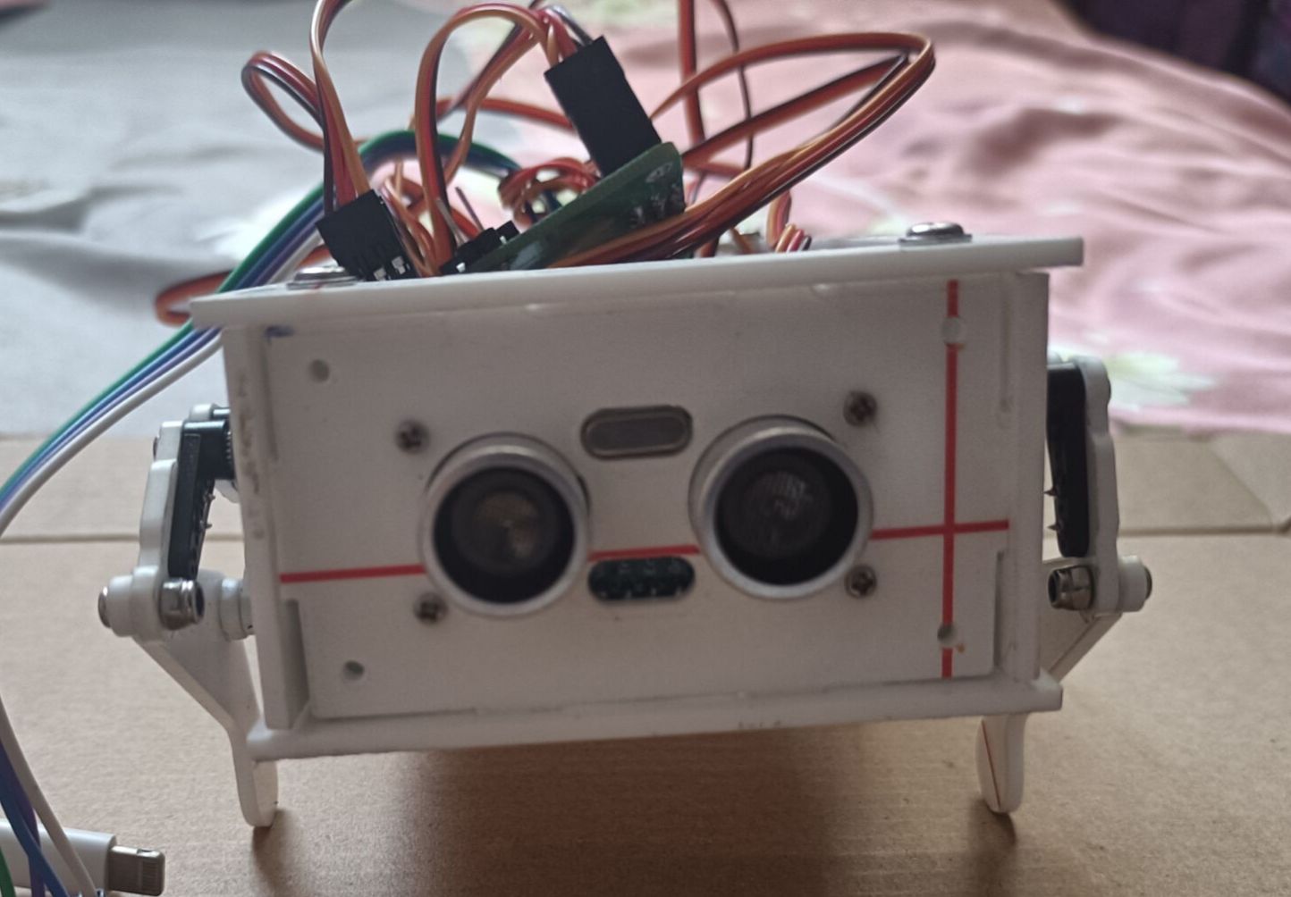

【Training Camp】Cool Dog
Cool dog design steps 1. Design the appearance of the dog by yourself by designing the schematic diagram and PCB 2. Purchase components for welding 4. Use Pycharm and Clion to debug the board and finally realize the desired function 5. Add some Peripherals, such as cameras, smart voices, etc. Schematic design instructions 1. For the design of the HI3861 schematic diagram, I used GPIO14 and GPIO13 pins as signal lines SDA, SCL.2. In addition, I directly connected the burning part with the HI3861 Designed together.HNJ3FE5@S_OT70(_0D%37ET.png
