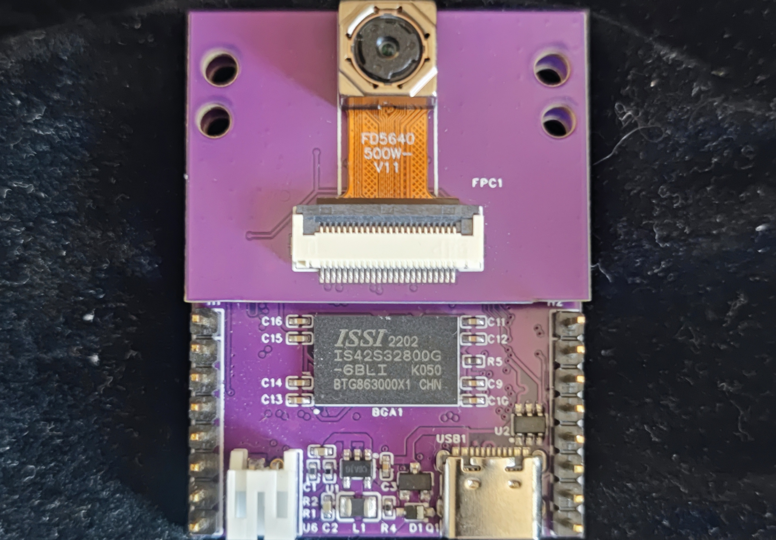

1. Draw the schematic
2. Draw the PCB
3. Make the board
3. SMT
4. Welding and debugging (you will know why SMT still needs welding later)
Design principle
Based on (defense?) STM32H743IIT6 to design OpenMV4 Pluse, LQFP package is more convenient for welding than BGA.
Note: OV5640 camera is self-provided, I bought it on Taobao for 33 yuan, if you want other cameras, you need to modify the camera PCB

Physical
displayDesign considerationsThere
are 4-layer and 6-layer designs. If conditions permit, 6-layer is used. The 4-layer is changed after receiving the problematic 6-layer SMT. The signal integrity of the 4-layer is definitely not as good as that of
other
6-layer SMT. After receiving the goods, I tested the power circuit and found a problem. I contacted SMT after-sales and asked them to change the resistor and try the DC-DC chip. Since I didn't have any DC-DC on hand, changing the resistor didn't work. In a hurry, I used AMS1117-3.3 to build a shed for emergency testing. It turned out that there was a problem with the SMT.
After the processing was completed, I modified the
modified
small board stacking game. The copper through-hole was aligned with the lower pad for connection. More tin must be added, otherwise it cannot be soldered, which means sacrificing the appearance.
