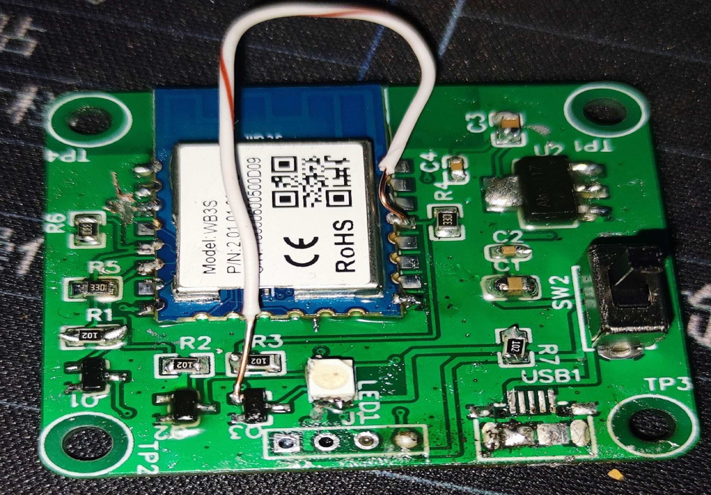

---- -First version of test, overturned
For the initial module, after welding it and powering it on, the LED would not light up. Others such as voltage and resistance are normal. Tuya APP can search for product names. At first I thought it was Tuya's configuration that was wrong (signal pull-down), then I connected the flying cable and changed it to pull-down power. After comparing the circuit diagram in the picture below, we found that there is nothing wrong with the design, except for the pull-up power. But the light still doesn't come on. After replacing two WB3S modules, I searched for the product names, indicating that there was no problem with the board (power supply). After discussion in the group, I discovered that the problem was that the module sent was not the same product as the board I made; Wan Duzi , and quickly reissued 3 WB3S modules. As of December 5, we are still waiting for the module. . . .MVIMG_20201205_180241.jpgMVIMG_20201205_180317.jpg
--- -Second test, successful
After a long wait (SF Express is quite fast), I got the new module on the morning of the 6th and immediately welded it for testing. The test was successful! The small light lights up normally!image.png

image.pngThe peripheral circuit of the module is also relatively simple. It should be noted that before designing the module circuit diagram, you must select the module firmware on Tuya Smart! Choose good module firmware! Choose good module firmware! Say important things 3 times! In the module firmware settings, check clearly whether the setting is "pull-up power" or "pull-down power"~~~ If you choose the wrong one, you will have to install "flying wires" after the board is ready. Although it is not troublesome, it is ugly. ah! ! ! !
