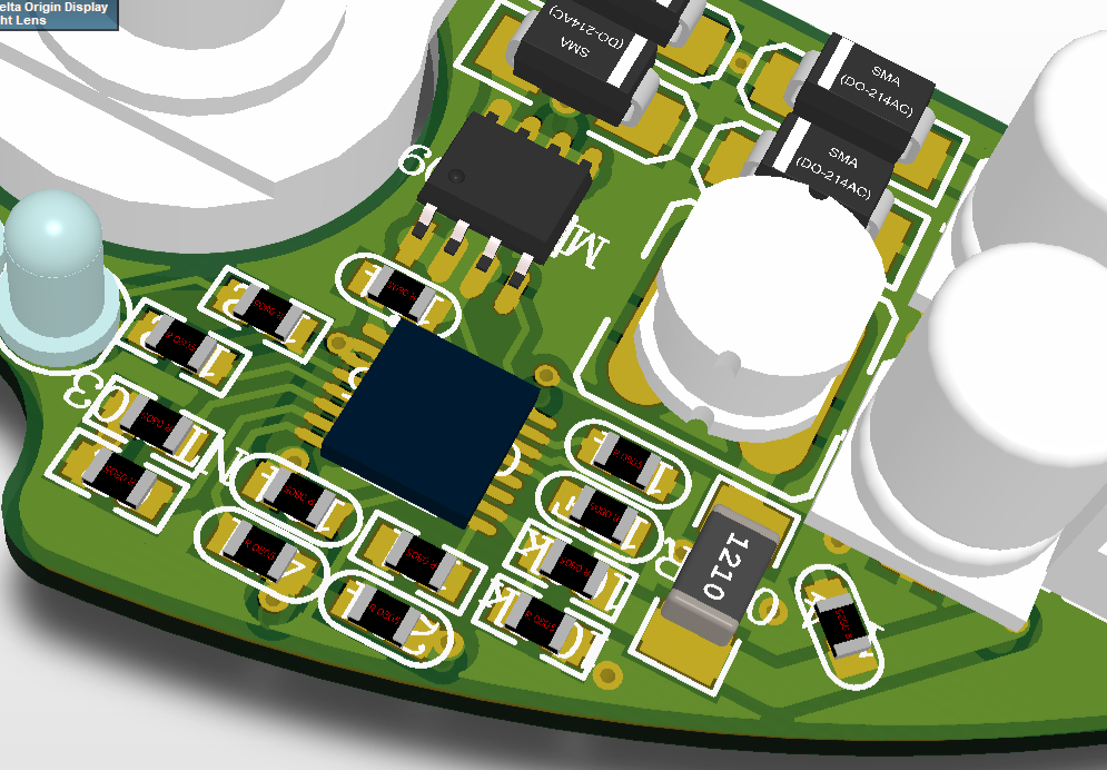

CN3705 has constant current and constant voltage charging modes, which is very suitable for charging lithium batteries or lithium iron phosphate batteries. In constant voltage charging mode, the constant voltage charging voltage is set by an external resistor divider network; in constant current charging mode, the charging current is set by an external resistor. 1. The voltage divider composed of R6 and R7 can set the constant voltage charging voltage. The value of this design is suitable for charging 6-cell lithium batteries (25.2v) 2. Resistor R4 can set the cut-off charging current. When R4 is 0R, the constant voltage Charging ends when the charging current is 9.17% of the set constant charging current. 3. Thermistor R2 can be replaced by a 10k resistor
