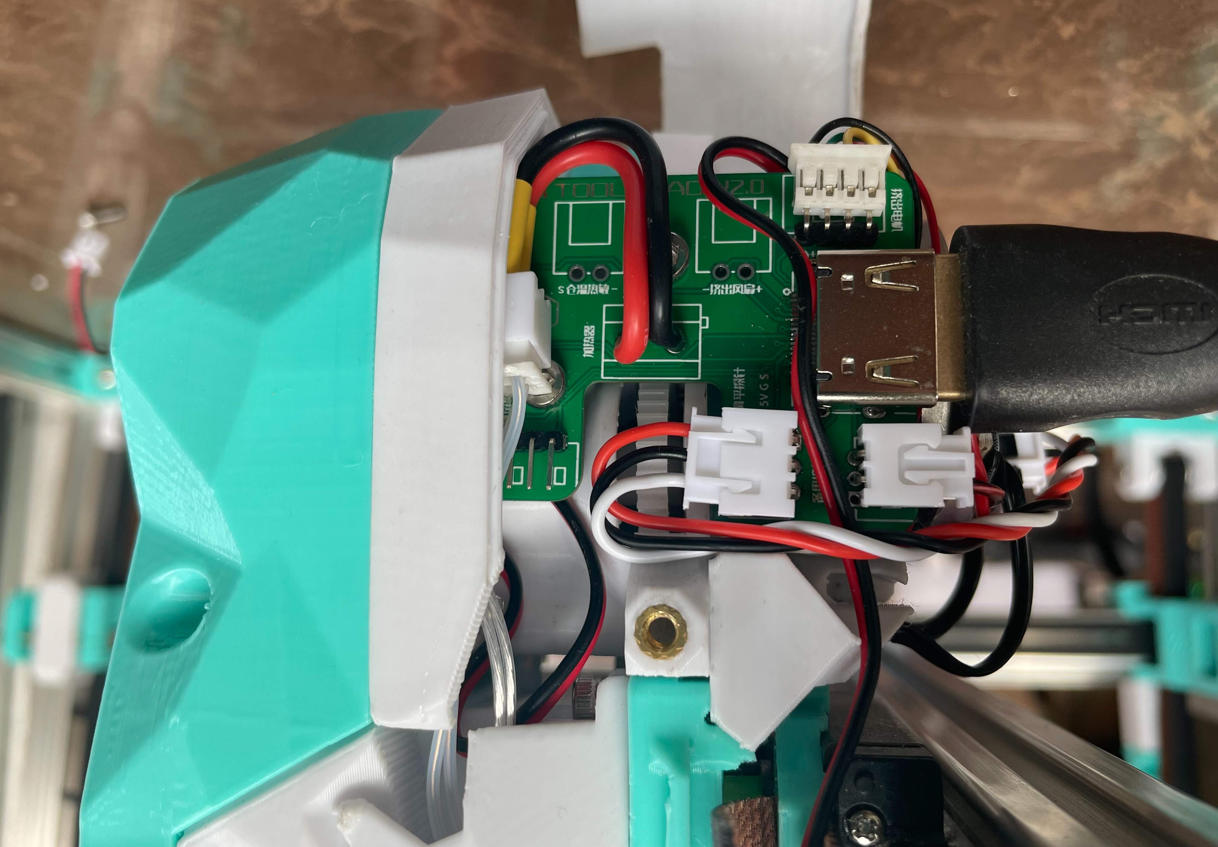

It's too expensive and it's troublesome to crimp the wires, so I made a simple hub board and used HDMI as the connection cable~
The board has enough interfaces reserved, and an additional temperature sensor and spare interface are added, as well as an extruder fan interface connected in parallel with the throat fan-
This project also includes lamp beads that can be plugged into the SB tool head, Euclid Probe V2 leveling (PCB version of Klicky)
The Euclid Probe V2 version simplifies the wiring compared to the original version, separates the functions of the upper and lower boards, and adds some voron logos (strokes
Assembly tutorial: [click here](https://euclidprobe.github.io/01_diybuild.html)

| Version | Print head end | MCU end | Is it verified?
V1.0 | The first version, there was interference during installation...I didn't put it up| | Yes |
| V2.0 | This time it can be installed stably and the cover can be closed, but the position of the interface still needs to be optimized | Center the HDMI interface | Yes |
| V2.2 | Fixed a silk screen error compared to version 2.0, and changed some interface positions | Added holes for 2.4 universal motherboard fixings | Yes |
##### *What's the matter with these strange version numbers? *
The print head end and the MCU end of the major version (V1.0, V2.0) are not universal, but the minor version (V2.0, V2.2) are universal
##### *Is HDMI reliable? *
Very stable. (After version 2.2, cable tie holes were added to assist in fixing)
##### *Are there enough interfaces? *
Completely enough.
There are two optional interfaces, X limit and spare interface. Both can be connected to other devices (such as rabbit color change)
