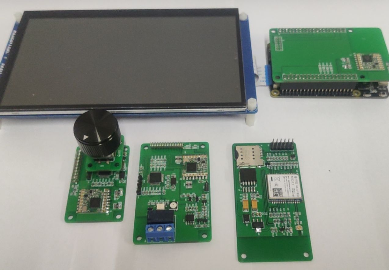

Overall display:
The 1.7-inch LCD touch screen and core board form a terminal control, which can control several electrical appliances through Bluetooth communication with a mobile phone.
2. Rotary encoder + RF module for lighting brightness and comfort level control and selection settings. Button selection function, which has the functions of left turn, right turn, and press confirmation. It uses the output phase difference of the pulse signal during rotation to confirm the left and right rotation.
3. Each independent electrical appliance is controlled by MCU + RF module + relay.
4. There is 4G real-time monitoring + control operation remotely, so that electrical appliances can be turned on and off remotely.
Partial display:
1. Remote control-NB module + local RF module:
2. RGB touch screen is used as touch display and physical control terminal.
3. Can be connected to the core board through APP (NB module cloud control) to control various electrical appliances.
4. If you forget to turn off the electrical appliances at home after going out, you can check it through the APP and control the on and off of the electrical appliances through the NB5313 module + RF98 module. (can also be used for industrial purposes)
5. There is a 4-bit hardware address to distinguish between the master and the slave.
Shuttle display:
The coding switch realizes the left, right and press confirmation functions.
Shuttle core board display:
1. Shuttle wireless control + local RF module:
2. Wireless selection + confirmation function switch composed of coding switch + RF98.
3. There is a 4-bit hardware address to distinguish between the master and the slave.
RF switch display:
1. Wireless switch + local RF module:
2. This is a wireless coding switch that communicates with other controlled electrical appliances through the RF module. Used for switching, function selection, function adjustment, etc.
NB remote control panel display:
1. Data can be transferred to the cloud for monitoring through the APP.
2. The APP sends instructions to the NB module through the cloud to remotely control electrical appliances.
Core expansion board
1. Core board + NB module controls the adjustment of global electrical appliances through wireless RF (433M) communication.
2. The core board can be used for local control of the 7-inch LCD.
