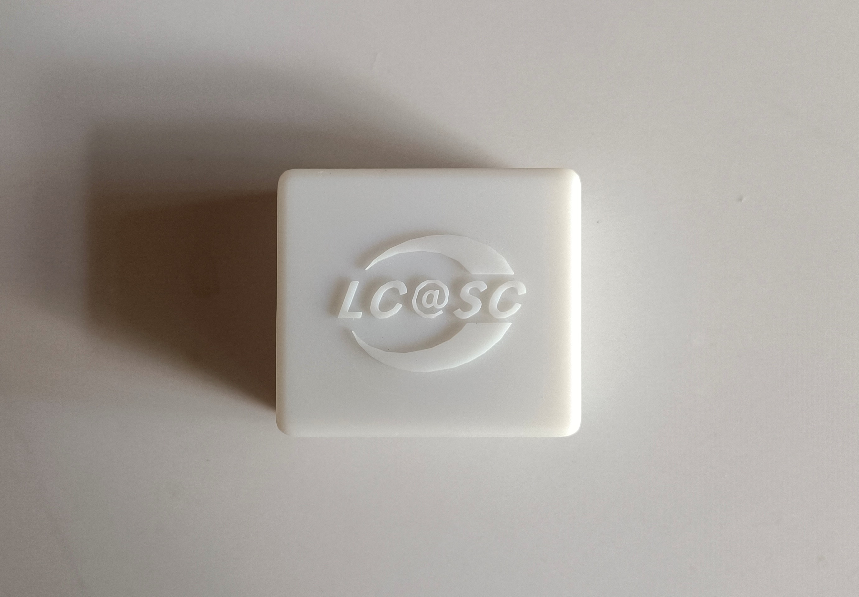

1. Introduction to project functions
         We are in an era where the Internet of Things and digitalization are booming, but there are still many scenarios in our lives that can be empowered and improved through digitalization. In modern life, health is the first priority, and physical health cannot be separated from exercise. In view of the lack of data analysis links in existing gym fitness scenes, I hope to design a universal detection device for motion data detection, and integrate fitness data into It can be transmitted to the mobile phone for viewing in real time, or the data can be analyzed on the computer, and the analysis results can be fed back to the formulation of exercise plans and other aspects.
   In order to realize the functional design of sports data detection equipment, I analyzed the movement patterns of most of the existing gym equipment and found their commonalities. The motion space of the gym is fixed, so its motion can be described as periodic reciprocating motion, and single-cycle motion can be described in terms of linear displacement and angular displacement. Therefore, the number of exercises, frequency, etc. can be calculated through the ranging sensor and angle sensor, and then combined with the model of the fitness equipment (obtaining the amount of exercise in a single cycle), we can estimate the overall amount of exercise, the number of exercises, and the frequency of exercise in a fitness session. Wait for data. Data can be transmitted to the mobile phone APP through the Bluetooth module , or transmitted to the network through other methods.
   The device is designed as a battery device. When Bluetooth is not connected, the device sleeps and when Bluetooth is connected, the device wakes up. Comes with a charging module, with LED indication when charging .

What we want to make is a device for detecting periodic motion, and periodicity is judged by angle and distance, so an angle sensor and a distance sensor are needed. I chose the commonly used MPU6050 angle sensor and Vite Smart VL53L0 infrared ranging. Sensor; secondly, the data processing and control core. I chose the very versatile Hangshun HK32F103C8T6 chip as the main control; then there is the data communication part, which can be used to communicate with mobile phones or access the network in other ways, using the Huicheng HC08 Bluetooth module , at the same time, the ZIGBEE communication module interface is reserved , which can be welded to the ZIGBEE module of Zeyao A40 ; finally, there is the power supply and power consumption control part. The power supply uses a 1s lithium battery, the module integrates a charging circuit, and is mainly reduced to 3.3V through a voltage stabilizing chip. Controlled power supply, each functional module is equipped with a power control switch, which can power off unused functions through pin signals.
