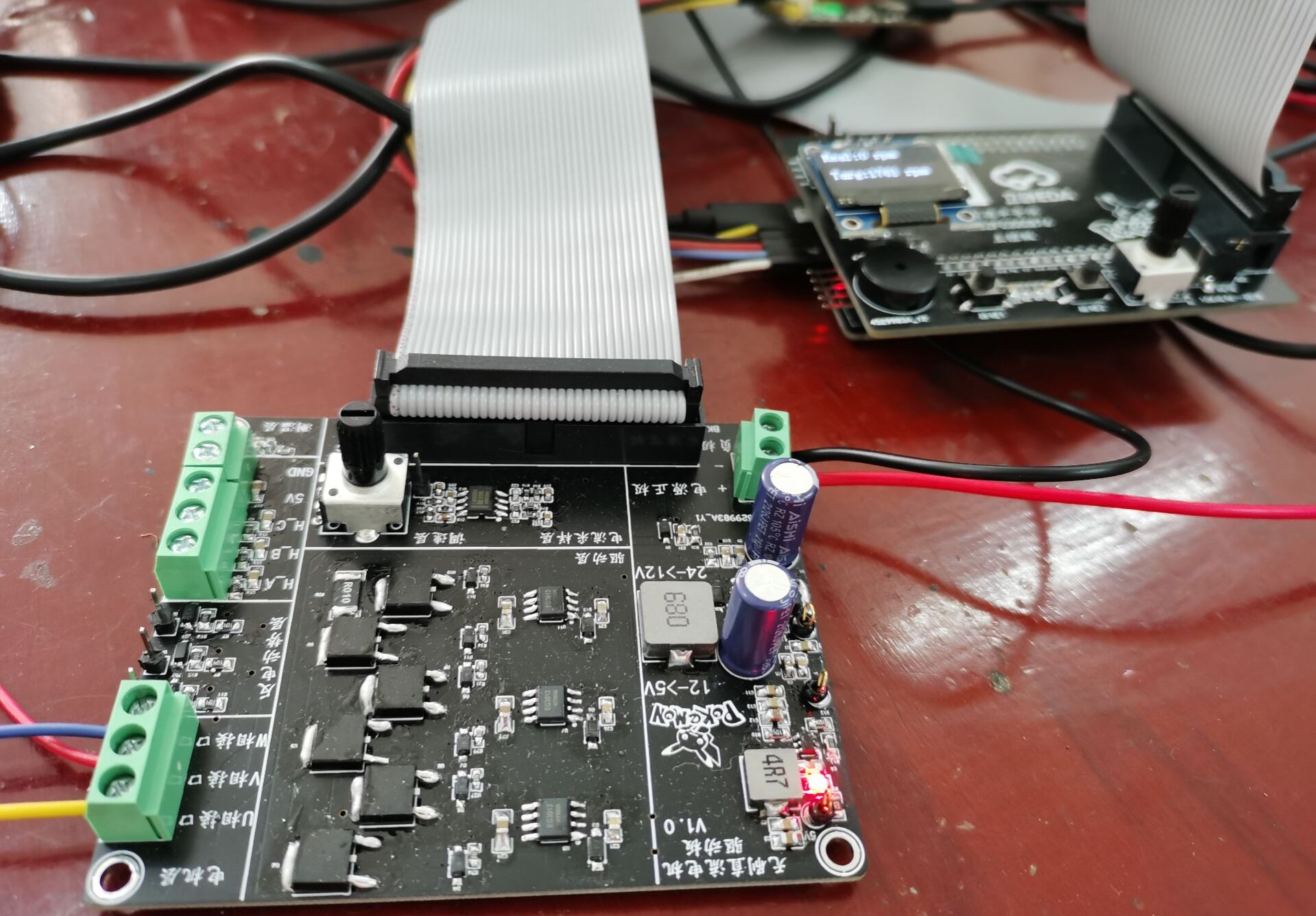

This project is designed with three boards. (Why I designed it this way: First of all, I didn’t want to integrate the chip! I hope to control one board and be able to play with some peripherals in the future without welding it to the motor board; Secondly, I originally planned to make FOC control for CW32F030C8T6. My driver board has also been made into FOC. It is still being tested. It will take some time before I share it. The school has been busy recently, so I have been delaying it. I will work hard later. After finishing it, this time I will finish the basic BLDC six-step commutation driver first; finally, you can refer to my design ideas, or you can inherit them all on a board, it’s all fine, no problem at all!)
1. Main control board: First, it is mainly powered by USB, which is stepped down to 3.3V by LDO to power the chip. It is worth noting that this chip is a chip with a wide voltage range and can directly supply 5V! Secondly, the SWD interface and UART interface are led out through the chip pins, which facilitates downloading programs and printing data from the host computer; finally, an onboard button reset circuit is added, and hardware debouncing is added to ensure the stability of the buttons.
2. Undertake board: This circuit mainly includes: buzzer circuit, LED light circuit, OLED display circuit, button circuit, knob potentiometer circuit and 2×17P bullhead female socket; it plays the role of taking over the main control board and driver board .
3. Driver board: This circuit mainly includes: power circuit, driver circuit, current sampling circuit, Hall signal circuit, back electromotive force circuit, motor interface layer circuit and temperature measurement layer circuit; it mainly plays the role of high-power driver.

If we want to drive a brushless DC motor in an open loop , what functions do we need to use?
1. Power supply part: 24V power supply; 12V for MOS drive circuit; 5V for Hall drive circuit; and power supply for main control chip
2. Main control chip: sends 6 PWM signals and 3 Hall sensor detection signals;
3. MOS drive circuit + three-phase full-bridge circuit;
4. Potentiometer circuit, controlling speed through knob;
5. OLED display function circuit
6. Current sampling part
