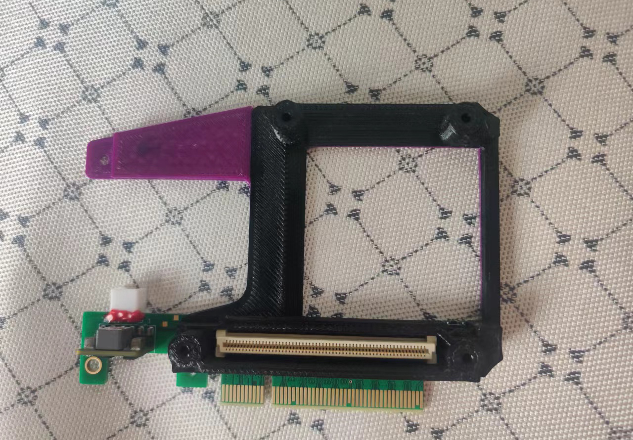

OCP adapter card x8 bandwidth, tested to support cx341 and LSI2308, remixed from keprice, based on which the wiring was re-routed to reduce the height by 4mm (although it is written as half-height, it is still about 9mm higher than the half-height bezel, compatible The half-height chassis will have more space than the original one.)
Because after lowering the height, the ground wire and power supply are not enough, and the differential signal lines on the two layers are crossed, a four-layer board was built.
A version without a fan is added (a switch is added, if some motherboards do not recognize the LSI2308, it can be solved by turning it to the gnd side)
Accessories include network card/array card brackets and baffles (the network card has a high socket and the array card has a short socket)
2022.08.29: The x16 version has been added according to the OCP design specification. There is no equipment so it cannot be verified. If you are capable, please check it out.
