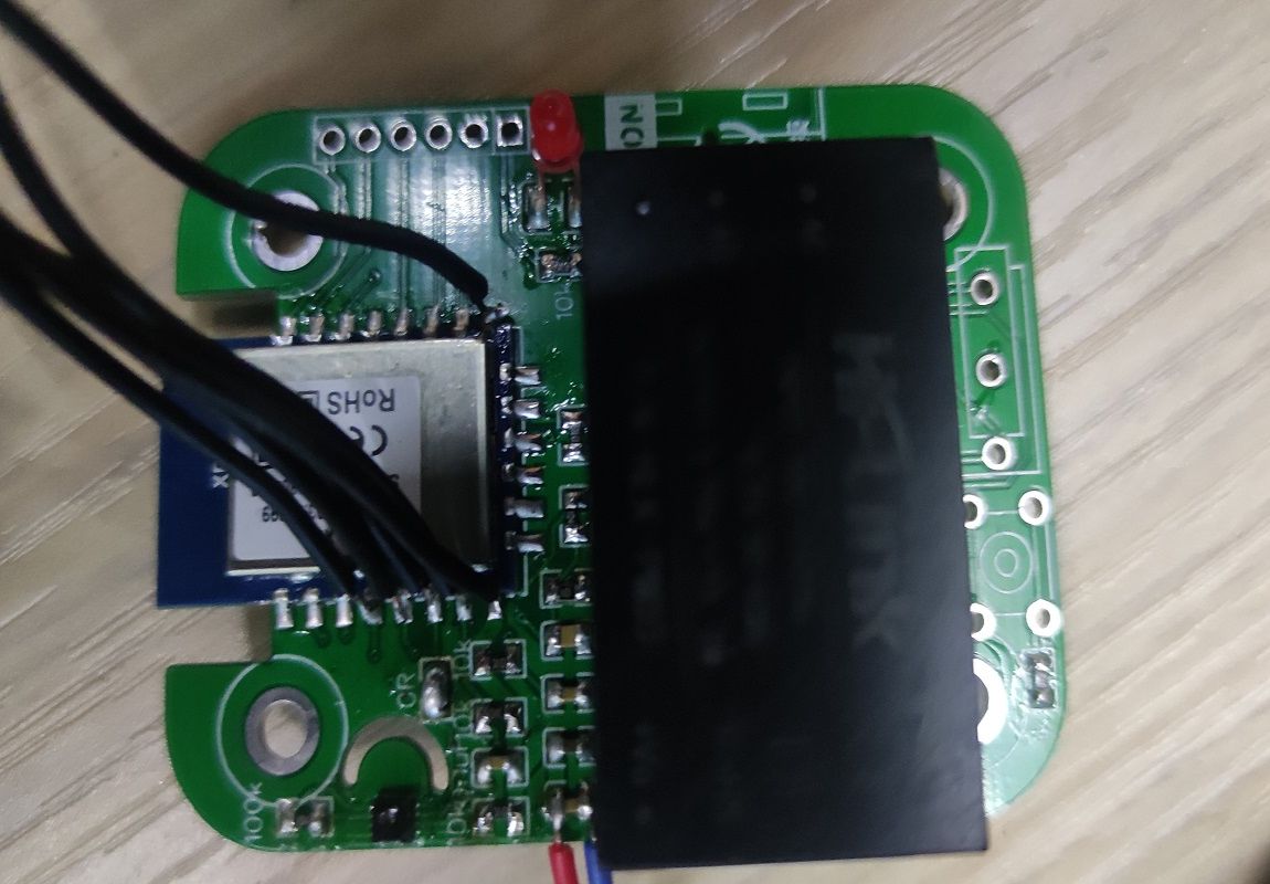

  10. Use Lichuang EDA to draw the schematic diagram based on the schematic diagram
  11. Generate PCB, proofing, purchase components, and solder PCB.
  12. The welding failed and the temperature and humidity could not be read. The SHT30 module was used instead. The modified PCB has not been sampled yet. The picture below shows the use of flying leads.
  14. Screenshot of software running
